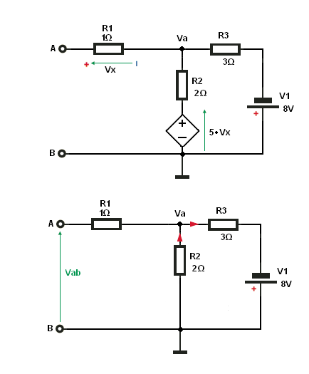

Thevenin Equivalent with a dependent source
RedDead
Joined Dec 12, 2010
14
Find the Thevenin Equivalent circuit between A and B
the circuit is in the attachments...
i don't know how to start
and what is the difference if A and B were for e.g after the 6V source?
thanks :D

To find Thevenin's equivalent at terminals a & b you need to find
1. The open circuit voltage Vab = Vth.
2. The current flowing from a to b when a & b are shorted together.
3. Hence find Rth = Vab(open circuit)/Iab(short circuit)

i know that, but i am confused about how to start because there is a dependent source.
how can i find Vx?

Well first you need to find Vth voltages
So diagram look like this
Vth = - V1 * R2/ (R2+R3) = -3.2V
And now we need to find Isc
So I write nodal equation
(Va - (-8V) )/3Ω = (0V-Va)/1Ω + ( (-5•Va) - Va )/2Ω
So the only think you need to do, is to find voltage at Va node.

Well I remove this resistor becaues it is connect parallel to the voltage source.
So this resistor has no effect on Va voltages.
