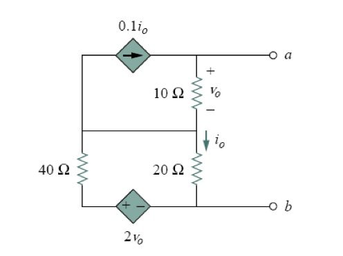

    hey guys :)
    I'm having some trouble figuring out the Thevenin equivalent for this circuit.
    [​IMG]
    I have started trying to analyse the circuit by inserting a 1V source across the terminals "a" and "b".
    With the 1 volt input across terminals "a" and "b", I have tried to determine the current entering the circuit to allow for determining the equivalent resistance of the circuit (Rth = 1V/I).
    This is when I starting getting confused.
    labelling the current through the 10 ohm resister i1 and the current though the 40 ohm resister i2.
    Analysing the the current at the short circuit (s/c => i1 and i2 entering while 0.1Io and Io leaving), led to my understanding that-
    Io + (0.1)Io = i1 + i
    Io = (10/11)(i1 + i2)
    I'm really not sure if my interpretation of the circuit is correct at all :( or even if I have the right approach to determining the Thevenin equivalent.
    Thanks so much guys

    Your logic up to this point seems fine. All that's left to do now is to develop a set of equations that will allow you to solve for the current leaving the 1V source you had applied across terminals a-b.
    I used mesh analysis for the job, but you can take whichever approach you prefer.
    Also, there is no need to analyze anything to do with the short circuit current. If you're doing so to try to the determine the thevenin voltage, well don't bother because it is zero, you only have dependent sources.

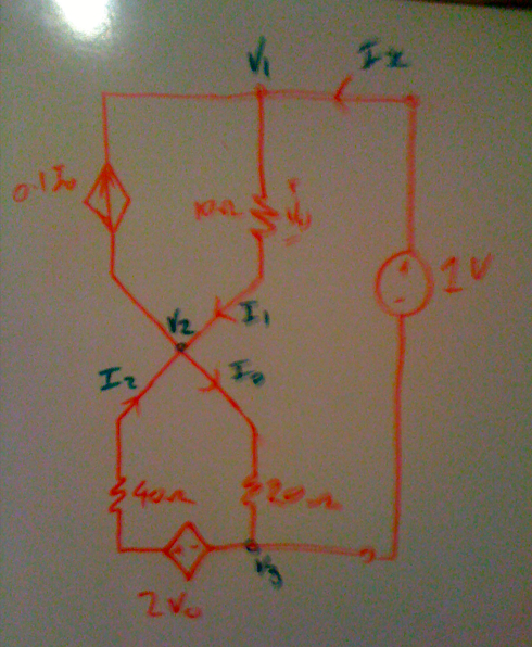

    I just a little confused by
    "there is no need to analyze anything to do with the short circuit current"
    because when I re-draw the cct-
    [​IMG]
    dont I fine the current leaving the 1V source (Ix) as -
    Vo = 1V = V1
    I2 = 2Vo/40
    = 2/40
    =1/20 A
    I1 = (0.1)Io + Ix = V1/10
    V1 = 1V
    I1 = 0.1A = (0.1)Io + Ix, (Io = (10/11)(i1 + i2))
    0.1 = 0.1(10/11)(0.1 + i2) + Ix
    11 = 0.1 + 1/20 + 11Ix
    11Ix = 10.85
    Ix = 217/220 A (0.986A ~ 1A)
    ... or is the just crazy talk?

    When you write equations for I2, why are you only considering the dependent voltage source?
    I would argue that,
    I2 = \frac{2V_{o} - V_{2}}{40 \Omega}
    Anyways, try taking a more structured approach to the problem, if not you find yourself always scrambling to generate equations, and making mistakes.
    You have three loops in the circuit you've drawn, one of which contains a dependent current source. From this you should be able to write 3 mesh equations. Also after doing so, you can define you dependent parameters such as Vo, io in terms of these mesh currents.
    You'll have generated a system of linear equations which can be solved using basic algebra.
    Jess_88 likes this.

    Jess_88 likes this.
  16. Jess_88
    Thread Starter Member
    Apr 29, 2011
    174
    1
    omg!!!
    IT WORKS!
    so Rth = 31.724Ω
    thanks so much guys.
    your the best!
