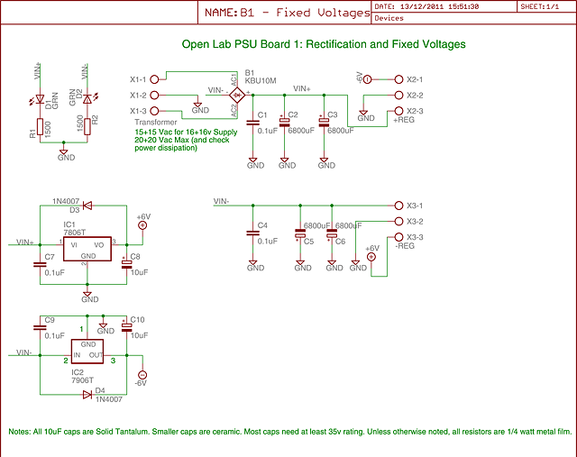

The rectifier board
The rectifier board has the rectifier, capacitor bank, and +6v and -6v regulators.
