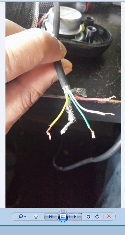

usb speaker wire was cut so i opened it and inside .
here is the wire from usb speaker
here is wire from my usb cable only

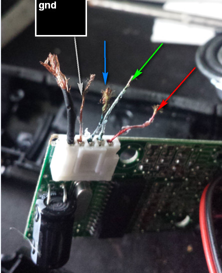

i connected
red with red
green with green
blue with white
gnd gnd i get usb not reconized plz help

A USB II cable or connector pin out is generally:
1. Red + Vcc (5 Volts)
2. White USB Data +
3. Green USB Data -
4. Black Ground
The remaining wire you have is Shield and generally not connected at the USB Device or it may be tied to Ground.USB Pin Out.png
What you seem to have is a header connector. Using a meter with the other end in hand you could ring it out pin to wire.
