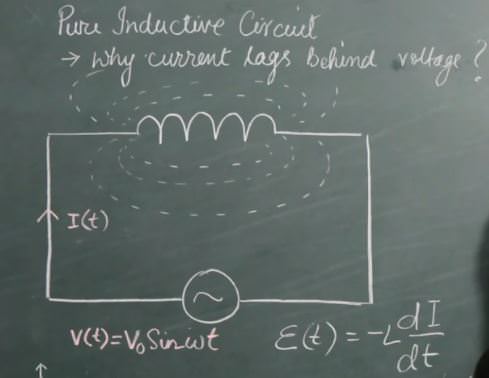

so, current and voltage in the primary are always exactly 90 degrees out of phase, regardless of number of turns, or core-type, or resistance, or frequency, or any other parameter?
this page says its <=90 deg. That seems to contradict your implication that the phase difference is always 90 deg. Is it 90 only with sines?
My understanding is that there's a direct relationship between current in the coil and EMF in the core. i'm asking about that relationship between current and EMF.
This formula seems to indicate that EMF increases as rate of change of current increases, regardless of the phase relationship between voltage and current.
E(t) = -L dI/dt
Meaning, i think, when current change-slope is fastest, we'll get highest flux. Ie, when current crosses 0. Doesn't matter what the voltage is doing, that's not in the equation.
That seems to contradict your comment that current is highest when V crosses 0.
Thx
Think that all you like but it's not true.
You are still confusing flux with voltage.
To repeat for the umpteenth time, flux is proportional to current, not voltage.
The rate-of change of current (flux) it proportional to voltage.
E(t) = -L dI/dt
Nope.
That equation is stating that the voltage (not flux) across an inductor is proportional to the rate of change of the current with time.
Transposing the terms we get di/dt = -E(t) /L.
This means the the rate of current change in an inductor is proportional to the applied voltage divided by the inductance.
Thus the rate of current change is fastest at the peak of the sinewave voltage.
And the inductor current keeps increasing as long as there is any voltage applied (for half the sinewave), thus the peak inductor current doesn't occur until the voltage returns to zero.
Below is the simulation with an applied square-wave that may help in your understanding.
Since the square-wave applies a constant voltage, the current-change slope is also constant.

What does the circled value represent?
Um... EMF? Electromagnetic Force? measured in Volts?
So... if Volts is a measure of difference between 2 points, then i guess the EMF of the coil means the potential difference between the two ends of the primary coil, measured in volts?

ok.... so the faster the primary current is changing, the higher the voltage across the primary, right?
Are both those traces on the primary side? It appears that, with a square wave, current peaks at the instant the square wave changes state from positive to negative, correct?
Yes.
It's actually the primary voltage that is causing the change in current, of course.
That's the primary voltage and consequent primary magnetizing current.
And yes, the current peaks at the point the square-wave changes state, since the inductor current keeps increasing as long as the voltage is applied.
