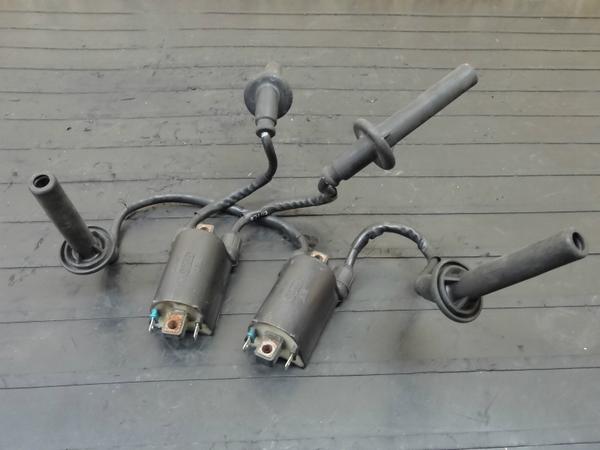

this is the coil which i have in my bike.
actually there was another incident which happened few years back. i think it is also related to this question.
one day i noticed that the sound of my engine was different. so first of all i checked the four exhaust pipes and one was running cold. then i pulled out the plug cap of that cylinder and the other plug cap of the same coil and checked the coil resistance with my multimeter. it was an open circuit according to the multimeter reading. so i removed both plug caps from the HT lines and then put my multimeter directly to the HT lines. then i got the correct resistance reading of the coil ( correct reading without plug caps according to the manual ). so there could be something wrong with the plug caps. after that i tested the resistance of the two plug caps individually and one showed open circuit. that plug cap had been connected to the cylinder which ran cold.
i purchased a used plug cap where the reading was correct and fixed it to my coil. finally i checked the coil resistance with plug caps on and the resistance was ok. since then i've been riding with that plug cap and haven't got any problem.
but according to the circuit if one plug cap shows open circuit the whole circuit opens. so both the plugs should fail. but it didn't happen in reality. only one cylinder ran cold and the other plug related to the same coil ran perfectly fine. so like @crutschow said it could be a short circuit which completes the firing of the other spark plug.

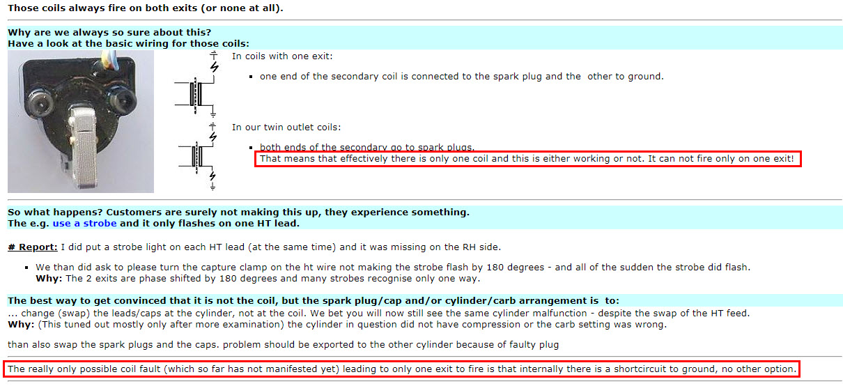

i found this interesting article.
as they say people have experienced a spark only on one side of the coil (only one spark plug fires). according to them (i have marked in red), if the circuit opens both the plugs should fail. reason is it's a single complete circuit. if only one plug fires it should be a short circuit which has not yet been manifested.
to be honest i haven't seen or heard a noise of an arc. but apparently it's the only way which creates a spark only on one side. thank you.

Another problem on these types of ign systems where the plug is deep in the cyl head. Is spark punches through the rubber/ silicon boot & causes one cylinder to not fire. When this happens on carefull inspection where ive marked, there will be a small black hole burnt through. Its quite a common fault.WASTED SPARK COILS.jpg
This is one thing, personally I wouldn't do. Maybe to get home if stranded but not as a way of making things right. Used ignition wires are not some thing to be trusted.
Like Debe said they over time will punch through or in some case get enough carbon on them to become conductive and short to ground.

Another problem on these types of ign systems where the plug is deep in the cyl head. Is spark punches through the rubber/ silicon boot & causes one cylinder to not fire. When this happens on carefull inspection where ive marked, there will be a small black hole burnt through. Its quite a common fault.View attachment 184498
this is a very useful info. i didn't know that. thank you.
yea you are right. does carbon build up inside the plug cap ? what is responsible for that ? thank you.

as a conclusion, considering the facts above and as @crutschow said it should be a short to ground which makes only one spark plug work. thank you all. much appreciated.
