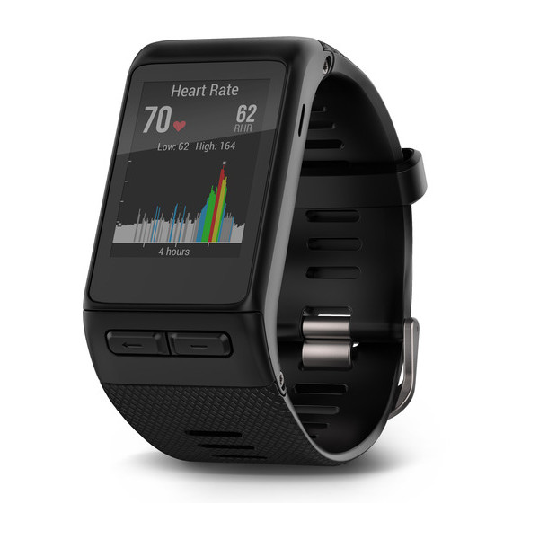

I have one of these, which I like a lot. It has buttons, a touchscreen and accelerometers. To a large degree it's "on" all the time. For instance it's a watch and it takes a heart rate reading every few minutes.
It syncs to my phone sporadically or when asked, but the bluetooth radio is likely off most of the time. The battery lasts a week or more between charges.
I think my point is that you can do whatever you want, and that it's already been done.

It appears that your watch was relying on a tactile button to activate the Bluetooth connection to the smartphone.
I think that is what I must do as well.
There are many waterproof tactile buttons available, so maybe that is not such a bad option after all.

To be honest I'm not sure what all it does. I can initiate a sync from my phone, so the watch must have some low power way to listen for a request from the phone. I would assume sending (transmitting) the data requires far more power than listening for a trigger. I can use the watch for days without ever touching its buttons or screen. But I do have to use the touchscreen and the buttons to tell it I'm about to start a run or a swim. I can also use the touchscreen to initiate an on-demand pulse measurement, or to see summary info about the days weather, my activities, recent texts and so on.
