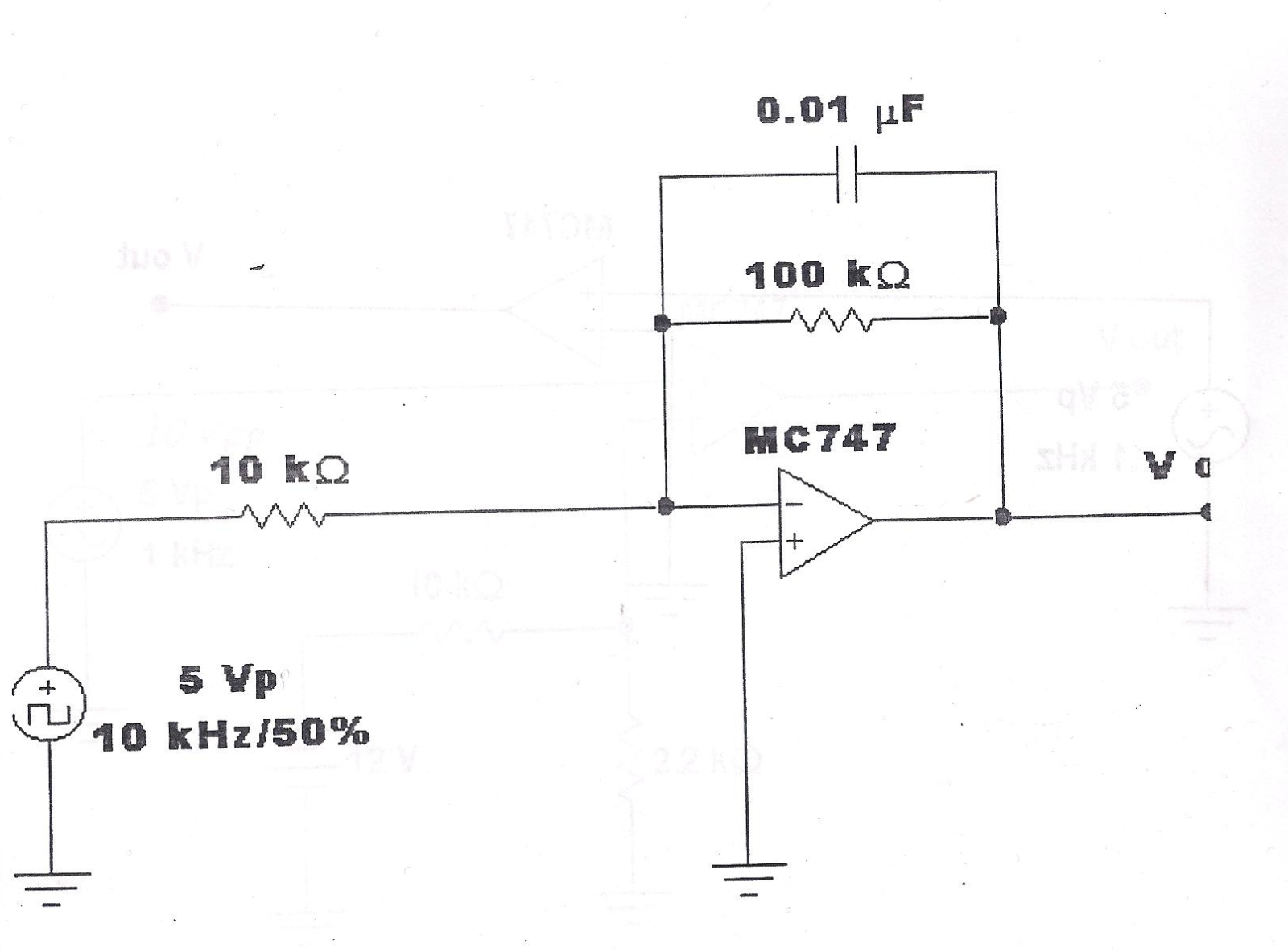

question ask to calculate the output voltage of the integrator. Assume the 100k ohm resistor behave as an open circuit.By, perhaps, doing what the equation says? Integrate Vin when it is a constant 5V and divide by the product of R and C.
Q1) What is the integral of 5V as a function of time?
Q2) What are your initial conditions (i.e., what is Vout at t=0)?
Okay, so assume that for t<0 that the input voltage was 0V. What is the output voltage at t=0s? Now assume that, at t=0s, the input voltage steps up to 5V. What is the current into the capacitor? What is the output voltage in terms of the capacitance and the current into the capacitance?question ask to calculate the output voltage of the integrator. Assume the 100k ohm resistor behave as an open circuit.
this is the diagram
