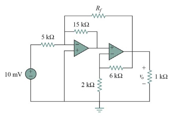

    I was wondering if I could get some help getting started with this question.
    Given Rf = ∞, determine Vo.
    [​IMG]
    Given Rf = ∞, I am thinking that there is no current flowing through the resister and therefore no voltage. So would I neglect it from my calculations???
    I'm also not sure how the input to the second out amp effects the circuit.... I'v only ever seen it connected to a negative input.
    I have started my analysis, finding the current through the 5kΩ and The 15kΩ resistor.
    I1 = 10mV/20kΩ
    Again... I'm not sure if I'm my method if correct at all... due to Rf.
    Thanks so much guys

    Yes - since Rf=∞ you simply neglect it in the calculations.
    You have two stages - the first is an inverting amplifier, the second a non-inverting amplifier. The overall gain magnitude is the product of the two gains - keeping in mind the inverting mode of the first stage. Will the overall gain have a positive or negative sign?
    You don't need to go from first principles to find the gain. See sections 2.2 & 2.3 in the link.
    http://en.wikipedia.org/wiki/Operational_amplifier_applications

    so for the first inverting amp
    v1 = -10mV(15/5) = -30mV
    and for the non-inverting amp
    v2 = -30(1 + 6/2)
    do I have to take into account the resistance at the output?
    or is v2 = vo?
    thanks so much for the quick reply :)

    The amplifiers are probably meant to be considered as ideal & would notionally have zero output resistance. So the load resistance would have no impact on the overall gain - which you seem to have correctly resolved.
