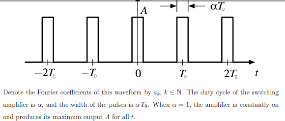

    [​IMG]
    [​IMG]
    [​IMG]
    Like i said i'm totally lost, anyone have any insight on any of these?:confused:

    You might start by writing an expression which describes the time function [the pulse train] in a form which could be used to derive the Fourier series coefficients.
    Remember the a0 term is simply the average value of the pulse train and it is written formally as
    a_{0}=\frac{1}{T}\int^{T}_{0}f(t)dt
    So how would you write the function f(t) over the interval t=0 to T
    Looking at the waveform you will have to break it into several parts -
    from t=0 to αT0/2,
    from t=αT0/2 to (T0-αT0/2)
    and from t=(T0-αT0/2) to T
    The same will be true for finding the other Fourier coefficients.
    If you think carefully about the average value case [a0] you don't need to do any integration ......

    Okay i have,
    x(t)= A from t=0 to αT0/2,
    x(t)= 0 from t=αT0/2 to (T0-αT0/2)
    x(t)= A from t=(T0-αT0/2) to T
    then would the average be (A*αT0)/T ?

    Correct.
    So if you make T=T0 (which is reasonable) what do you have for the average.
