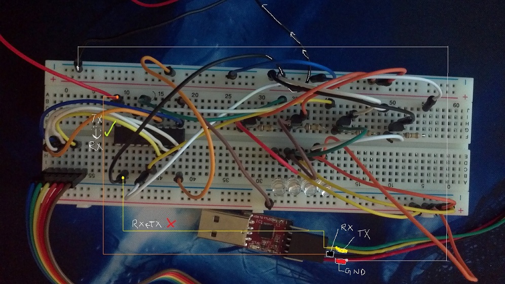

I've been having some difficulties making the damn serial communication to work.
For 3 days I couldn't sleep, eat, drink .. It's driving me crazy.
(Slightly exaggerated, but for real, I don't know what to do anymore)
So here is the scenario.
I've set up and connected the PIC16F689 with CP2102 (USB to UART Bridge) and with putty I get the output from the MCU but I can't for the love of what is holy send anything to it. It just doesn't cooperate.
Details :
Env : MPLAB X IDE 1.50
Programmer : PICkit3 (used to power the MCU as well, 3,3V)
Compiler Toolchain : XC8 (v1.11)
PIN 10 (RB7/TX/CK) connected to RX pin on CP2102
PIN 12 (RB5/AN11/RX/DT) connected to TR on CP2102
PIN 20 (Vss) connected to the GND on CP2102
I don't know how to draw schematics so here is a picture (just for completeness, I don't know If you can see anything from all the wires, but maybe you will see something else that I did wrong) :

I've tried the code in Stimulus, and it works as expected .. Or so I think since
MPLABX Stimulus is a bit different from the older one in mplab 8.
The thing is in Stimulus here I can set the register RCREG, which apparently sets the RCIF interrupt bit as well. So it executes nicely.
However, a thing to notice is that it doesn't skip the while(!RCIF) at startup.
Somehow I think this is "cheating" and the actual transmission on the RX pin is skipped and the only way this works on Stimulus is because im directly setting the RCREG register.
