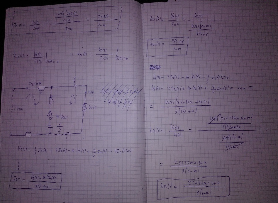

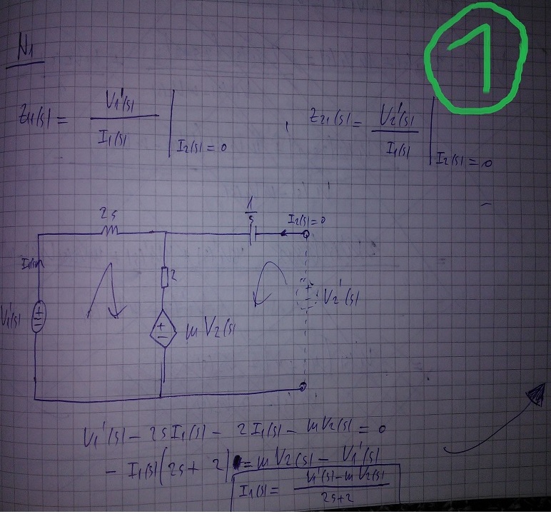

    Hi!
    [​IMG]
    My task is to find z parameters of individual networks and z parameters of whole network (z=zN1+zN2).
    Here is what I have done:
    [​IMG]
    [​IMG]
    [​IMG]
    [​IMG]
    [​IMG]

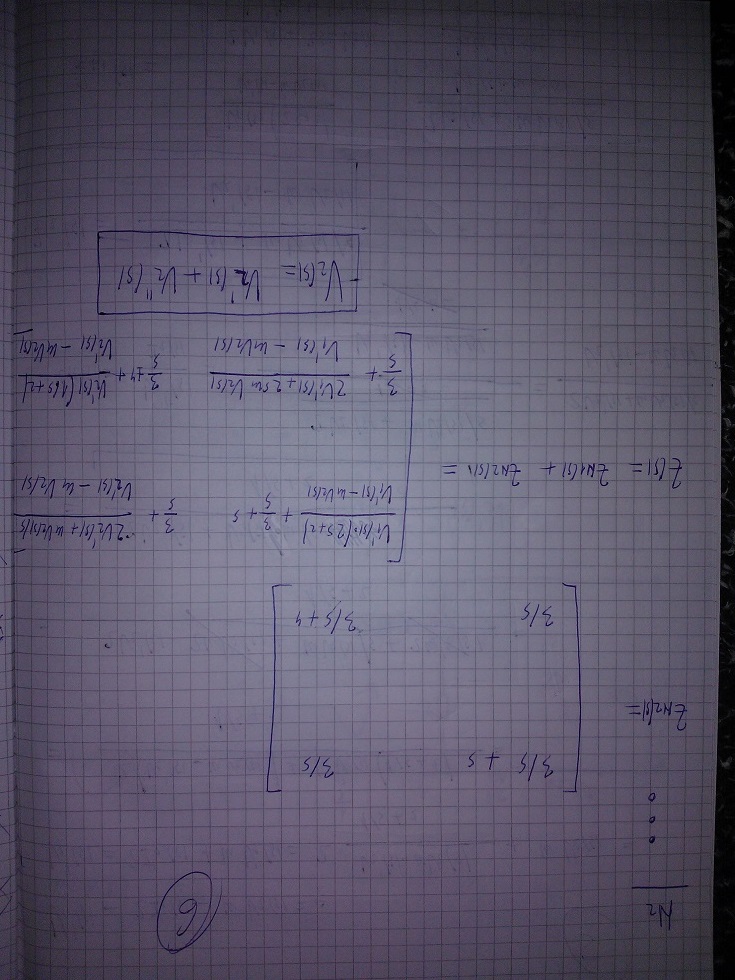

  2. xxxyyyba
    Thread Starter Active Member
    Aug 7, 2012
    289
    7
    [​IMG]
    Is it ok?
  3. t_n_k
    AAC Fanatic!
    Mar 6, 2009
    5,448
    790
    I'd like to help but can't read what you've posted owing to the poor contrast in the images.
  4. The Electrician
    AAC Fanatic!
    Oct 9, 2007
    2,702
    493
    I will echo t_n_k's comment. However, I was able to save the images and increase the contrast, but you shouldn't post hard to read images when you're asking for help. If you make it too hard for those who would help you to read your work, they may just decide it isn't worth it.
    Your result for the Z matrix of N2 is correct, but the Z matrix for network N1 isn't correct.
    Why does the Z matrix for N1 involve V1' and V2? I think you haven't dealt with the dependent source correctly. The Z matrix should not involve V1' and V2.

  8. xxxyyyba
    Aug 7, 2012
    289
    7
    Just to mention that I analysed whole circuit without using rule for series connection and I got:
    z11=((3*s+2+3/s)*(1-m)+m*(2+3/s))/(1-m);
    z21=(2+3/s)/(1-m);
    z12=(2*s+4*s*m+3+m)/(s*(1-m));
    z22=(4/s+6)/(1-m);

    When you're working on ZN1, use the fact that V1'' and V2'' are zero. In other words, V1' = V1 and V2' = V2. This should help you eliminate the unwanted voltages.

    I can't be sure I'm reading your final result correctly. Would you please type the result from page 5 into a post, transcribing very carefully? :)
    I find that with the result I get, it's not true that Z = ZN1 + ZN2. Do you get that result also?
