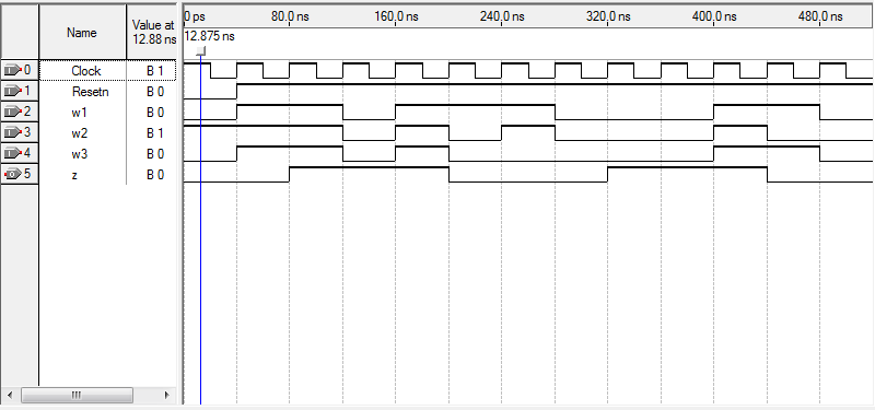

The second question is similar to the first but in need to make a fsm that has three inputs w1, w2, w3 that if equal for any three consecutive cycles z will be 1. Here are some test inputs and their outputs:
w1 = 0110111000110
w2 = 1110101000101
w3 = 0110100000110
z = 0001100001100

a) From outputs this is a mealy fsm my state table and diagram are:
To get x I made a circuit to see if w1, w2, w3 are equal (in vhdl code).
b)My problem with this is my vhdl code seems to have a similar problem as the first question and I can't figure it out. I let the states be auto assigned this time.
VHDL:
This results in this sim output which seems to be making z = 1 at two not three:
w1 = 0110111000110
w2 = 1110101000101
w3 = 0110100000110
z = 0001100001100
I need to:
a) Show state table.
b) Write vhdl code.
VHDL:
Rich (BB code):
