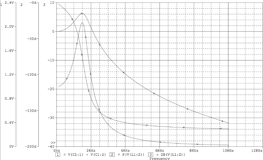

    I'm having some trouble determining w1 and 12.
    so far I have.
    wo = 1/(sqr(LC)) = 10 000
    fc = (1/(2pi*(sqr(LC)))) = 1591.54
    Wpk = wo*(sqr(7/8))
    Fpk = 1488Hz *(Wpk/(2*pi))
    now this is my confusion.
    From-
    w1 = -(R/2L) + sqr[((R/2L)^2) + 1/LC] = 7.807kHz
    w2 = (R/2L) + sqr[((R/2L)^2) + 1/LC] = 12.8kHz
    but from my simulations.
    [​IMG]
    Where did I go wrong?
    cheers guys

  7. t_n_k
    AAC Fanatic!
    Mar 6, 2009
    5,448
    790
    For the frequency response I would expect the peak value to occur when
    \omega=sqrt{\frac{1}{LC}-\frac{R^2}{2L^2}}
    Which gives ω=9354.14 rad/sec or 1488.76Hz
    You have a peak on your frequency plot close to that frequency.

  9. t_n_k
    AAC Fanatic!
    Mar 6, 2009
    5,448
    790
    Firstly, the unit for ω is rads/sec not kHz. You must divide ω by 2π to convert.
    Unfortunately even when converted to frequency as kHz you'll note these aren't -3dB points on the mid-band gain.
  10. t_n_k
    AAC Fanatic!
    Mar 6, 2009
    5,448
    790
    With an appreciable amount of algebraic manipulation, the upper -3dB frequency can be found from...
    \omega=sqrt{\frac{1}{LC}-\frac{R^2}{2L^2}+\frac{1}{2LC}sqrt{(8+\frac{R^4C^2}{L^2}-\frac{4R^2C}{L})}}
    Which gives an ω=14845.094 rad/sec or 2362.67 Hz
    The -3dB point is off the mid-band gain of 1 [0dB], rather than the peak at 1488.76Hz. These values agree well with your graphical plot.

  11. t_n_k
    AAC Fanatic!
    Mar 6, 2009
    5,448
    790
    A "purist" might argue that the -3dB point should be taken off the peak response value - not the mid-band gain of 0dB. There's some reasonable justification for this.
    The peak response value at 1488.8Hz is +6.3dB. Can you prove this?
    So if one searches for a solution for frequency where the gain is 3.3dB [i.e. 3dB down from 6.3dB] then one arrives at values of
    f1=995Hz
    f2=1855Hz
    Again the solution requires working through some algebraic gymnastics.
    So take your pick as to which answer better satisfies the original problem definition.
    Jess_88 likes this.
  12. Jess_88
    Thread Starter Member
    Apr 29, 2011
    174
    1
    Do you think you could post derivation?
    I'm still getting the wrong values... :(

  13. Jess_88
    Apr 29, 2011
    174
    1
    ok so on my graph, f1 and f2 are taken from the dB response at 6.6dB and 3.3dB while
    -3db is at 2362.67Hz right?
    Also by looking at the graph there is only w1 and no w2 right?
    Would I also be correct in assuming the +6.6dB is due to the given dampening ratio being 0.25?
    I'm having trouble calculating these values... I keep getting values out by at least 500Hz. Could you post your calculations?
  14. t_n_k
    AAC Fanatic!
    Mar 6, 2009
    5,448
    790
    Perhaps we should find some common ground ...
    I have the complex frequency domain transfer function G(ω) as
    G(\omega)=\frac{1}{[(1-\omega^2 LC) +j\omega RC]}
    The transfer function magnitude value |G(ω)| is therefore
    |G(\omega)|=\frac{1}{sqrt{(1-\omega^2 LC)^2+\omega^2R^2C^2}}
    At peak response frequency f=1488.8 Hz or ω=9354.4 rads/sec
    |G(ω)|=2.066 or 6.3dB
    We want to find the -3dB points where G(ω)=3.29 dB (exact -3.01dB point)
    A |G(ω)|dB gain of 3.29dB is equal to a |G(ω)|=1.461
    We then have to solve for ω values giving
    |G(\omega)|=\frac{1}{sqrt{(1-\omega^2 LC)^2+\omega^2R^2C^2}}=1.461
    or
    (1-\omega^2 LC)^2+\omega^2R^2C^2=\frac{1}{(1.461)^2}
    Solving for ω [by quadratic method] gives real values ω1=6254 rad/sec & ω2=11657 rad/sec

  16. t_n_k
    AAC Fanatic!
    Mar 6, 2009
    5,448
    790
    The gain roll-off will approach 40dB per decade rather than 60dB per decade.
    You've shown a partial Bode magnitude plot in your earlier post ...???

    1
    Sorry, where did I show a partial Bode magnitude plot???
    Would this be from my image earlier posted in this thread?
    Thanks for bringing this to my attention... I would assume this would be the dB response from the image right?
  20. t_n_k
    AAC Fanatic!
    Mar 6, 2009
    5,448
    790
    That's right - in post #4 - the dB plot.
