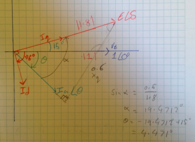

    Here is my phasor diagram.
    Does it look ok?
    [​IMG]
    I'm getting pretty confused with my trig :(

  14. t_n_k
    AAC Fanatic!
    Mar 6, 2009
    5,448
    790
    This is how I saw it ....
    Jess_88 likes this.

    Thanks t_n_k,
    Could you explain a how you got your 75 angle? I think there may be a relationship I'm not aware of.
    I was looking at it from my phasor as, 90 degree difference from Iq to Id. So subtracting 15 from 90 to give -75 from the x axis.
  16. t_n_k
    AAC Fanatic!
    Mar 6, 2009
    5,448
    790
    Yes - since IqXq is orthogonal with Ea it must be true with \delta = 15° that the opposite angle is 75°. Just to be clear, this applies to the right-angled triangle formed by the sides V_{T} \ , \ I_{q}X_{q} and \(E_{a}-I_{d}X_{d}\).
    Jess_88 likes this.

  18. t_n_k
    AAC Fanatic!
    Mar 6, 2009
    5,448
    790
    Not to find the 75° - which by the way is essentially superfluous information. It was meant to indicate the right angle triangle lying along the VT and Ea phasors.
    The relevant relationships for finding Id & Iq can be extracted from the formulas shown at the top of page on the phasor diagram of post #14
