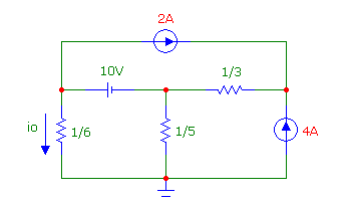

So above given is the circuit I am supposed to find the Thevenin Equivalent of with respect to the 1/5Ω resistor load.
I've sort of managed to put something together, however, it seems totally wrong...

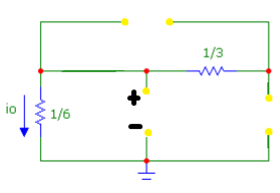

Setting all other non-included sources to 0, I get:
Is this on the right track at all or have I completely lost it?
