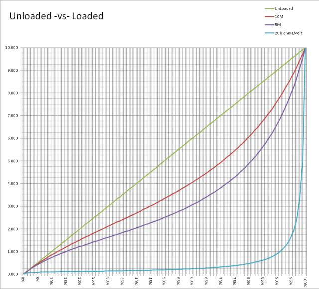

I posed a problem at another forum ... what would your multimeter read if the linear potentiometer was set at 50%
Afterwards, I supplied this graph with a 10 M input impedance, a 5 M, and a simpson 260 at 20k/volt.
Knowing what your meter should read would be invaluable. That is why your meter's input impedance should be greater than 10x your circuit impedance. Remember the simple problem of the total resistance when a 1M is in parallel with a 100k or maybe a 10k ...
