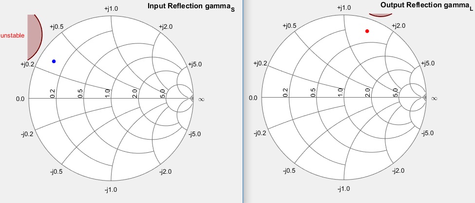

    While getting enough forum entries to open a blog where eventually all POZAR exercises may be solved with MATLAB (in blue font), this kind of exercise posted by Alex1234 is quite common in Microwave engineering starter modules.

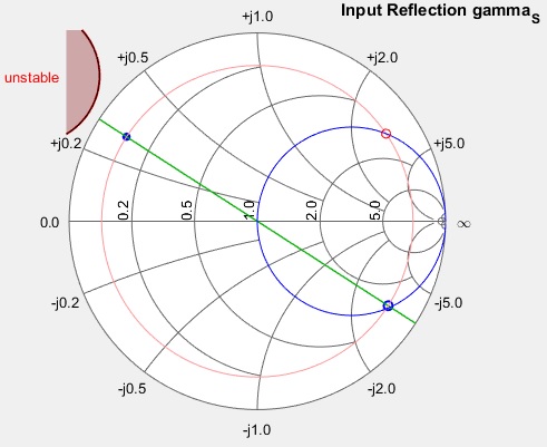

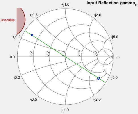

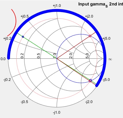

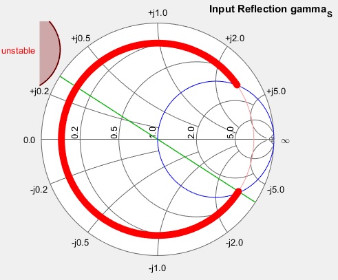

    hf1=figure(1);smithchart; % input reflection on Smith chart, with input stability circle
    ax1=hf1.CurrentAxes
    hold all;plot(ax1,xc_in,yc_in,'LineWidth',1.5,'Color','r');
    title(ax1,' Input Reflection gamma_S','HorizontalAlignment','left')
    plot(ax1,real(gamma_S),imag(gamma_S),'bo','color','blue','MarkerSize',5,'MarkerFaceColor',[0 0 1])

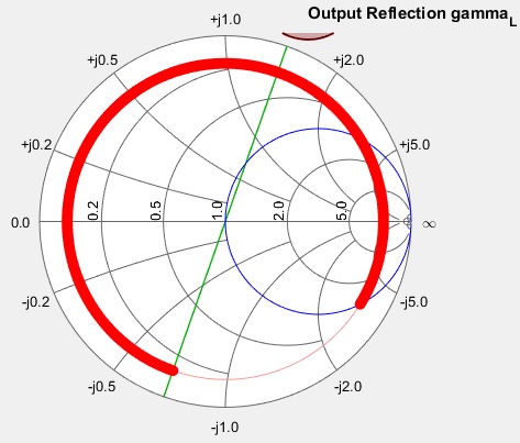

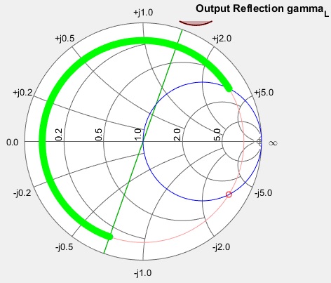

    xc_out=R_stability_OUT*cosd(a)+real(Centre_stability_OUT);
    yc_out=R_stability_OUT*sind(a)+imag(Centre_stability_OUT);
    hf2=figure(2);smithchart; % output reflection on Smith chart, with output stability circle
    ax2=hf2.CurrentAxes
    hold all;plot(ax2,xc_out,yc_out,'LineWidth',1.5,'Color','r')
    title(ax2,' Output Reflection gamma_L','HorizontalAlignment','left')
    plot(ax2,real(gamma_L),imag(gamma_L),'bo','color','red','MarkerSize',5,'MarkerFaceColor',[1 0 0])
    % showing where input and output reflections would be unstable
    if (abs(Centre_stability_IN)>R_stability_IN); % circle does not comprise (0,0) then in port is STABLE OUTSIDE CIRCLE
    figure(1);text(real(Centre_stability_IN),imag(Centre_stability_IN),'unstable','Color','r','HorizontalAlignment','center');
    center1(1)=real(Centre_stability_IN);center1(2)=imag(Centre_stability_IN);
    color=[.5 0 0]; N=100;
    a=linspace(0,2*pi,N);
    r0=ones(1,N)*R_stability_IN;
    [X,Y] = pol2cart(a,r0);
    X=X+center1(1);Y=Y+center1(2);
    h=fill(X,Y,color);h.FaceAlpha=.3;
    end;
    if (abs(Centre_stability_IN)<R_stability_IN); % circle comprises (0,0) then in port is STABLE INSIDE CIRCLE
    figure(1);text(real(Centre_stability_IN),imag(Centre_stability_IN),'stable','Color',[0 .8 0],'HorizontalAlignment','center')

    if (abs(Centre_stability_OUT)>R_stability_OUT); % circle does not comprise (0,0) then in port is STABLE OUTSIDE CIRCLE
    figure(2);text(real(Centre_stability_OUT),imag(Centre_stability_OUT),'unstable','Color','r','HorizontalAlignment','center')
    center2(1)=real(Centre_stability_OUT);center2(2)=imag(Centre_stability_OUT);
    r0=ones(1,N)*R_stability_OUT;
    X=X+center2(1); Y=Y+center2(2);
    h=fill(X,Y,color); h.FaceAlpha=.3;
    end;
    if (abs(Centre_stability_OUT)<R_stability_OUT); % circle comprises (0,0) then in port is STABLE INSIDE CIRCLE
    figure(2);text(real(Centre_stability_OUT),imag(Centre_stability_OUT),'stable','Color',[0 .8 0],'HorizontalAlignment','center');
    color=[0 .5 0]; N=100;
    end;
    [​IMG]
    Respective source and load impedance
    Z0=50
    Z_S=gamma2z(gamma_S,Z0)
    Z_L=gamma2z(gamma_L,Z0)
    Z_S and Z_L are looking outwards
    [​IMG]

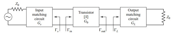

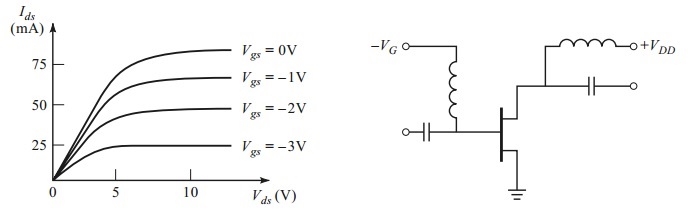

    because you are building input and output matching networks with
    components that at the same time perform DC decoupling and
    transistor bias.

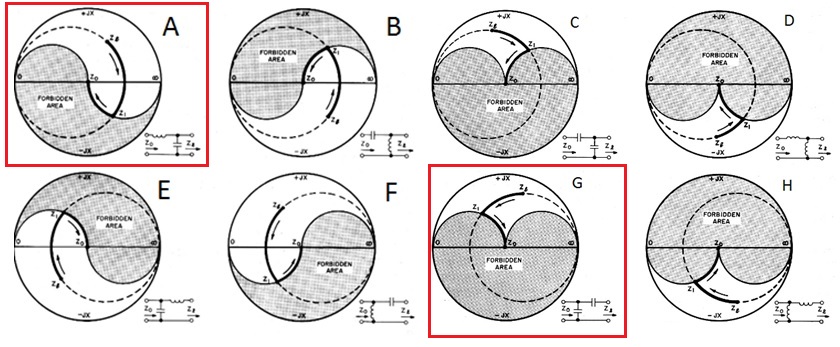

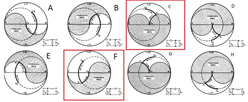

    Depending on what quarter of the Smith chart the reflection of a given port is located,
    then there are 2 possible matching networks for each port.
    Input
    [​IMG]
    Output
    [​IMG]

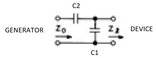

    for instance the case for series C parallel C would be
    [​IMG]

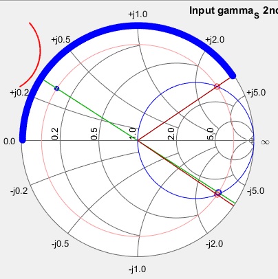

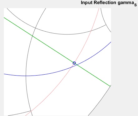

    Z_S = 5.1357 +14.5861i
    1st shift from Z_S to R=Z0 circle
    syms B1
    eq1=Z0==real(1/(1j*B1+1/(Z_S)))
    B1=real(double(solve(eq1,B1)))
    if knowing the frequency, that is not the case, then
    to obtain the value of C1 the following would be possible:
    B1=C1*Z0*2*pi*f0

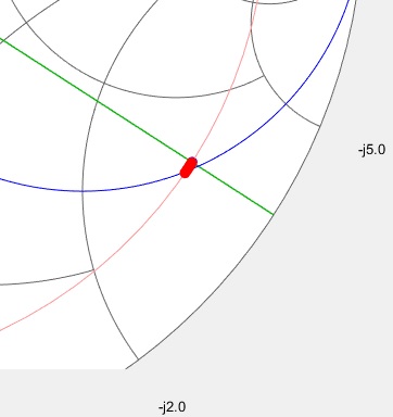

    2nd shift, zeroing reactance:
    syms B2
    eq2=abs(imag(1/(1j*B2)+1/(1j*B1+1/Z_S)))==0.001
    B2=double(solve(eq2,B2))
    ignore the negative result
    B2=B2(B2>0)
    again the 2nd capacitor value could be calculated provided f0 known
    B2=C2*Z0*2*pi*f0

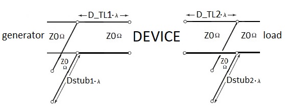

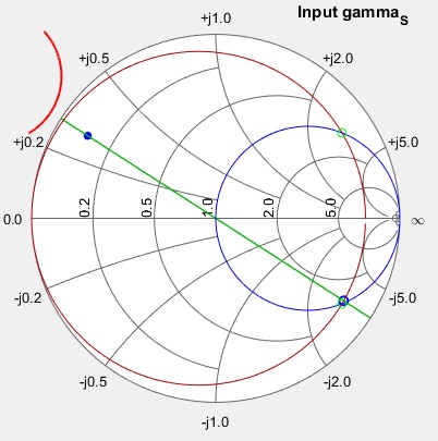

    Since you've mentioned in the question it's requirement to use shunt stubs and series sections of transmission lines,
    [​IMG]
    transmission line plus single open circuit stub match (on single frequency) is POZAR 4th edition exercise 5.14
    5.14 already solved with MATLAB, scheduled for posting in blog soon.
    https://forum.allaboutcircuits.com/...ter-5-example-1-with-ads.151173/#post-1295405
    instead of moving impedance along constant resistance or constant
    reactance circles as it's the case when using lump circuit elements,
    series transmission lines shift impedance along constant SWR circles.
    Zin=ZL*(ZL+1j*Z0*tan(beta*L))/(Z0+1j*ZL*tan(complex_prop_const*L) % ideal transmission line
    Zin=ZL*(ZL+Z0*th(complex_prop_const*L))/(Z0+ZL*th(complex_prop_const*L) % ideal transmission line
    But for circuits with small amount of components, it may require less calculations to solve with the Smith Chart
    Also recommended to read example 12.3 page 573 of POZAR 4th edition.
    If you have the 3rd edition, instead, look at the Smith chart on page 622 that completes example 11.6
    Now, to use a Z Smith chart as Y chart by simply spinning 180deg the reflection coefficient:
    left side Short Circuit on Z Smith Chart is Open circuit on Y chart,
    and right side Open Circuit on Z Smith Chart is Short Circuit on Y chart.
    gamma_yS=-gamma_S
    yS=1/Z0*(1-gamma_yS)/(1+gamma_yS)
    plot(ax1,real(gamma_yS),imag(gamma_yS),'bo','LineWidth',1.5)
    Smith_plotOpRefLine2PhaseCircle(ax1,Z_S,Z0,[0 .7 0]);
    Smith_plotOpRefLine2PhaseCircle(ax1,1/yS,Z0,[0 .7 0]);

    now we are going to move the impedance along the SWR red circle until the
    real part equals Z0
    [x_swr,y_swr]=Smith_plotGammaCircle(ax1,Z_S,Z0,[1 .6 .6]);
    [xr1,yr1]=Smith_plotRcircle(ax1,Z0,Z0,[0 0 1])
    [xint,yint]=intersections(x_swr,y_swr,xr1,yr1);
    xint=xint(find(yint>0));yint=yint(find(yint>0)) % discard yint<0
    plot(ax1,xint,yint,'ro')

    Observe that Ys is close but not right on the real(Zin)=Z0 constant resistance circle
    [​IMG]
    how long has to be the transmission line departing from the device towards generator to bring the real part of the
    source impedance equal to Z0?
    abs(180/pi*(angle(gamma_yS) - angle(xint+1j*yint)))
    = 67.059122630177228 % degree
    abs(.25/pi*(angle(gamma_yS) - angle(xint+1j*yint)))
    = 0.093137670319691 % wavelengths

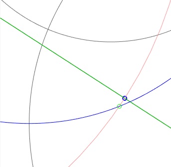

    check circles crossing match, green marker should overlap red marker on intersection:
    Y1=(G1+1j*B1)
    gamma_z1=(1/Z0-Y1)/(1/Z0+Y1)
    gamma_y1=-gamma_z1
    plot(ax1,real(gamma_y1),imag(gamma_y1),'go')
    match to the positive solution found with support function intersections.m

    graphically drawing long Transmission Line arc on Smith chart
    a_in=angle(gamma_yS)
    plot(ax1,real(gamma_yS),imag(gamma_yS),'ro')
    a_target2=angle(gamma_y1)
    plot(ax1,real(gamma_y2),imag(gamma_y2),'ro')
    a=a_in;a_tol=a_target2*0.01;a_step=2*pi/5000; gamma=gamma_yS % init gamma sweep
    winL1=a_target2*(1+a_tol);winL2=a_target2*(1-a_tol) % catch window
    da=a_step
    while ceil(100*a)/100>winL1 || ceil(100*a)/100<winL2
    gamma=gamma*exp(-1j*a_step); % exp(-1j*) is CW, towards generator
    a=angle(gamma);da=da+a_step
    plot(ax1,real(gamma),imag(gamma),'ro','LineWidth',1.5);
    end
    a1=da
    [​IMG]
    long angle, in degree
    180/pi*a1
    2.928960000000026e+02

    Output match:
    gamma_yL=-gamma_L
    yL=1/Z0*(1-gamma_yL)/(1+gamma_yL)
    plot(ax2,real(gamma_yL),imag(gamma_yL),'bo','LineWidth',1.5)
    Smith_plotOpRefLine2PhaseCircle(ax2,Z_L,Z0,[0 .7 0]);
    Smith_plotOpRefLine2PhaseCircle(ax2,1/yL,Z0,[0 .7 0]);
    [x_swr,y_swr]=Smith_plotGammaCircle(ax2,Z_L,Z0,[1 .6 .6]);
    [xr1,yr1]=Smith_plotRcircle(ax2,Z0,Z0,[0 0 1])
    plot(ax2,xint,yint,'ro')
    keep turning still towards generator.
    it's actually towards load, but it's the test generator replacing
    the load and marching towards the generator again.
    gamma_y1=xint(1)+1j*yint(1)
    gamma_y2=xint(2)+1j*yint(2)
    y1=1/Z0*(1-gamma_y1)/(1+gamma_y1)
    y2=1/Z0*(1-gamma_y2)/(1+gamma_y2)
    check
    1/y1
    5.001474552579269e+01 - 1.619932608083966e+02i
    1/y2
    on R=Z0 constant impedance circle, as expected
    a_in=angle(gamma_yL)
    plot(ax2,real(gamma_yL),imag(gamma_yL),'ro')
    a_target2=angle(gamma_y2)
    plot(ax2,real(gamma_y2),imag(gamma_y2),'ro')
    a_step=2*pi/5000; gamma=gamma_yL % init gamma sweep
    da=a_step
    plot(ax2,real(gamma),imag(gamma),'go','LineWidth',1.5);
    end
    a1=da
    short TL angle, in degree
    180/pi*a1
    2.192399999999899e+02
    [​IMG]

    hf3=figure(3);smithchart; % input reflection
    ax3=hf3.CurrentAxes
    hold all;plot(ax3,xc_in,yc_in,'LineWidth',1.5,'Color','r');
    title(ax3,' Input gamma_S 2nd intersect','HorizontalAlignment','left')
    plot(ax3,real(gamma_S),imag(gamma_S),'bo','color','blue','MarkerSize',5,'MarkerFaceColor',[0 0 1])
    plot(ax3,real(gamma_yS),imag(gamma_yS),'bo','LineWidth',1.5)
    Smith_plotOpRefLine2PhaseCircle(ax3,Z_S,Z0,[0 .7 0]);
    Smith_plotOpRefLine2PhaseCircle(ax3,1/Z_S,1/Z0,[0 .7 0]);
    [x_swr,y_swr]=Smith_plotGammaCircle(ax3,Z_S,Z0,[1 .6 .6]);
    [xr1,yr1]=Smith_plotRcircle(ax3,Z0,Z0,[0 0 1])
    plot(ax3,xint,yint,'ro')
    Smith_plotOpRefLine2PhaseCircle(ax3,y1,1/Z0,[.7 0 0]);
    Smith_plotOpRefLine2PhaseCircle(ax3,y2,1/Z0,[.7 0 0]);
    da=1/100;a_stub=[angle(gamma_y1):da : pi];arc_stub1=da;
    gamma_stub=.99*(cos(a_stub)+1j*sin(a_stub));
    arc_stub1=arc_stub1+da;
    plot(ax3,real(gamma_stub),imag(gamma_stub),'bo','LineWidth',1.5);
    angle_OCstub1=180/pi*abs(angle(gamma_y1)-pi)
    2.142307901340358e+02
    [​IMG]

    close all
    hf4=figure(4);smithchart; % input reflection
    ax4=hf4.CurrentAxes
    hold all;plot(ax4,xc_in,yc_in,'LineWidth',1.5,'Color','r');
    title(ax4,' Input gamma_S','HorizontalAlignment','left')
    plot(ax4,real(gamma_S),imag(gamma_S),'bo','color','blue','MarkerSize',5,'MarkerFaceColor',[0 0 1])
    plot(ax4,real(gamma_yS),imag(gamma_yS),'bo','LineWidth',1.5)
    Smith_plotOpRefLine2PhaseCircle(ax4,Z_S,Z0,[0 .7 0]);
    Smith_plotOpRefLine2PhaseCircle(ax4,1/Z_S,1/Z0,[0 .7 0]);
    [x_g1,y_g1]=Smith_plotGcircle(ax4,1/Z_S,1/Z0,[.7 0 0])
    [xr1,yr1]=Smith_plotRcircle(ax4,Z0,Z0,[0 0 1])
    [xint,yint]=intersections(x_g1,y_g1,xr1,yr1);
    plot(ax4,xint,yint,'go')
    [​IMG]
