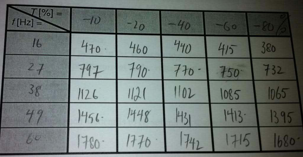

5. On the DC drive control panel, set the reference torque at a negative value corresponding to the braking of the AC motor. The torque is displayed as a percentage of the motor nominal value, and can be varied in the range of 0 to (-80%).
6. In the table below, record the displayed values of frequency f (AC drive control panel), torque T and speed n (DC drive control panel).
7. Record the drive speed for at least four other frequency values, selected to cover evenly the remaining range up to 60 Hz. The torque is maintained constant by the torque controller of the DC drive.
8. Repeat steps 5, 6 and 7 for at least four other torque values, selected to obtain measurement points spread evenly in the range of 0 to (- 80 %). The set of frequency values at which the speed is measured remains the same for each torque value.

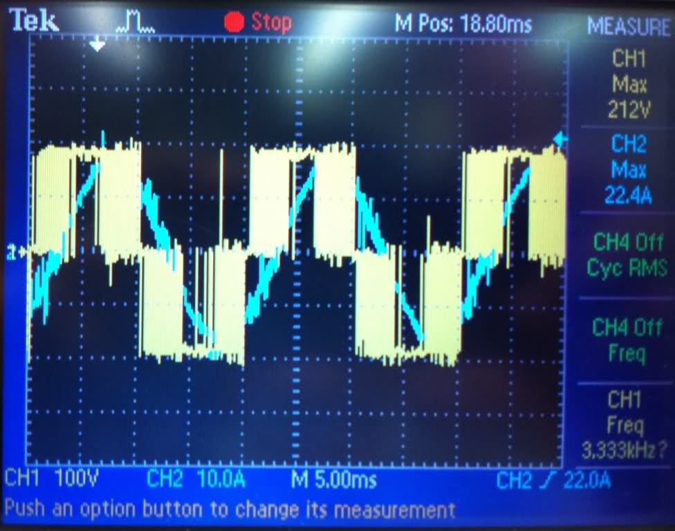

Output Voltage and Current Waveforms of a PWM VSD.
1. On the oscilloscope, monitor the phase current and the phase voltage of the induction motor. Keep the motor loaded with a torque of at least (-50%) (as displayed on the DC drive).
2. Sketch the waveforms for three widely spaced frequencies in the range of 25 – 60 Hz. Note the differences between the voltage waveforms. Note that, in your report, you are required to include the scale of the presented graphs.
3. Measure the amplitude of pulses in the voltage waveforms.
4. Note the response of the phase current to the voltage pulses.
50Hz
Anyone can tell my why the current waveforms are of the shape shown above and why the amplitude of the pulses in the output voltage is constant and how the output voltage magnitude is varied?
I didnt read your post very thoroughly, but i think i can add some clarity here.
In order to approximate the ideal drive waveform for motors, which is sinusoidal, the method is often to PWM the drive circuitry.
What you see on the yellow (voltage) trace isnt constant voltage, it is PWM voltage, and it appears constant because of your time scale.
Were you to zoom in your time scale i would imagine you would see square waves.
The current waveforms are sinusoidal because thats what the motor windings need to operate smoothly - granted they arent the prettiest sine waves, but varying load and frequency will cause the induced current to not be necessarily ideal, but still effective.

The voltage ouput of an AC drive isn't a pretty sine wave like you might expect. It's called Pulse Width Modulation. Full voltage ("full" as determined by a V/Hz table or other algorithm depending on control mode) is pulsed in the KHz range in the + or - direction. The motor windings "average out" these pulses. That is why the current graph looks like a sine wave, while the voltage graph looks like garbage. The Duty Cylce (time ON vs. time OFF, expressed in 0-100%) is varied produce peak "averaged" voltage at the peak of the wave form and half voltage in the middle of the waveform and everything in between. This pluse frequency is referred to as "carrier frequency" and this is what you will read if you measure the frequency of the drive output with a digital multimeter. In order to measure the 0-60Hz (or 0-400Hz or whatever) output of a drive accurately you need a DMM with a low pass filter, designed for the task such as Fluke 289. If you want to see a pretty voltage sine wave on your o-scope you may be able to use a lo-pass filter in the same manner, but I wouldn't be able to instruct you how to do this as I've never attempted it.

I mean if you look at the waveforms @ 30, 40 and 50Hz, they voltage (Square shape) waveform is the same with the same magnitude.
LEt say i want to increase or decrease it. How i can do that? i am thinking of reducing the DC bus voltage.

Depending on what drive you have, read the manual. I would say probably not, because that voltage is calculated by the drive with factors of motor pole wiring, motor power factor, motor rated slip, motor rated current, motor thermal time constant, et.al. (and ultimately by the V/Hz table)

As I was trying to explain, the motor windings "average out" (yes, I will continue to put quotes around that) the voltage pulses sent through them. Think of them as big inductors. since the current flowing through them is an average of pulses, the amperage graph shows a more-or-less nice sine wave.
EDIT: I guess the "quick & dirty" way to change that voltage would be to change the nameplate motor rated voltage parameter in the drive. Should be safe to go down with this number, but don't enter a number higher than what's on the nameplate. Just remember that a whole lot of stuff is calulated from those few motor namplate data paramters, so changing them could drastically alter the performance. that specific voltage is being applied for a reason.
Hi Bro,
from basic circuit analysis, u know that for inductor, current lags the voltage, i.e. V=L*di/dt. The same case is here, voltage waveform leads and current lags because motor is inductive load with windings as inductors.
