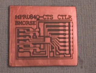

    Thanks for the compliments Alberto....
    I use several, but the one I use the most is KCAM by Kellyware..... It is good enough to be doing 2D stuff such as PCB's...... Here is a small 16 Lead QFN package that I milled on it, pretty accurate down to about 5000th of an inch.... the only thing is finding milling bits that small with an 1/8" shank ( I buy lots of refurbished ones from Harbor Freight though....)
