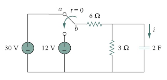

    Hi
    I need to fined i(t) for te following circuit.
    [​IMG]
    I think I know what I'm doing, I'm just a little stuck on using
    I(t) = V/R + C (dv/dt)
    so this is what I have so far-
    V(0-) = 30V(3Ω/(6Ω + 3 Ω) = V(0) = V(0+)
    = 10V
    Removing the capacitor
    Rth = 6Ω + 3 Ω
    \tau = Rth x C = 2 x 9
    At t>0
    V(∞) = 12V(3Ω/9Ω)
    V(t) = V(∞) + [V(0) - V(∞)]e^(t/\tau)
    = 4 + [10 - 4]e^(t/18)
    = 4 + 6e^(t/18)
    this is were i started getting confused.
    so I(t) = V(0)/Rth + C (dv/dt) right??
    = (10/9) + 2(d/dt (4 + 6e^(t/18)))
    =10/9 + 2((6)(1/18)e^(t/18))
    =10/9 + (2/3)e^(t/18)
    dose that look right?
    looking at an example, it looks like its on the right path... but I dont understand the rule that was used in the differentiation in the example.
    isn't
    d/dx ke^x = k((d/dx)x)e^x ?
    thanks a bunch guys :)

    Rth would not be 9Ω.
    From the point of view of the capacitor it "sees" an equivalent resistance of 3Ω in parallel with 6Ω. Consider the DC source as a short for this purpose.
    The other way to view this is to reduce the 12V source and the two resistors to a Thevenin equivalent at the connections to the capacitor.

    so, with Rth = 2ohms used in my calculation would my procedure to answering the question be ok?
    I feel like I could be completely miss interpreting the correct method in applying the formulas.

    I just noticed that I didn't include two minor things for the original problem statement.
    1) the circuit is at position "a" for a long time before switching to "b"
    2)calculate i(t) for ALL t>0
    this shouldn't change much... but just incase.
    So I have redone the question.
    hope its right this time everything is ok.
    V(0-) = 30(3/(6+3)) = V(0) = V(0+)
    = 10V
    removing the dc source to determine the Req for the time constant ( time const i'm denoting by s, because i cant fined the math symbols in quick post).
    Req = 3//6 = 2
    s = RC = 4
    V(inf) = 12(3/9) = 4
    V(t) = V(inf) + [V(0) - V(inf)]e^(-t/s)
    = 4 + [10 - 4]e^(-t/4)
    i(t) = v(inf)/R +C(dv/dt)
    =4/3 + 2(6 x (-1/4)e^(-t/4))
    =4/3 +-3e^(-t/4)
    which looks good to me, but in a similar example there appears to be another differential equation...
    did I miss something out?
    did I differentiate correctly?
    thanks guys :)
