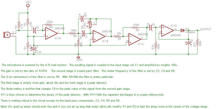

Here is a similar circuit, this circuit was used to start robots in a sumo competition by a whistle blow, it is set to detect a certain pitch sound usually from a piezo buzzer...

Is it better to use a piezo transducer or a electret microphone for this purpose? Could you please recommend me any reading to help me better understand the matter?
tom66
Joined May 9, 2009
2,595
Any such circuit designed for a lost keychain will need a long battery life, so that excludes any kind of active amplifier. BMorse, your circuit will draw a few mA from the batteries, so it will stop working in days to weeks if run off a coin cell battery. You'd need a device which when moved produces a voltage. An electret microphone does not do this, it requires a supply voltage, while a piezo transducer does.

A piezo will usually produce a VERY high voltage, when pressed I've seen upwards of 300V. <snip>
So who is going to be "pressing" the piezo while he is looking for his keys?? :D
A piezo sensor does not create usable voltage if used for detecting "sound", you will have to amplify the output to get any usable voltage out of it.... They are great for vibration or movement sensors, but when it comes to trying to pick up a certain sound frequency, the output needs amplifying.....
