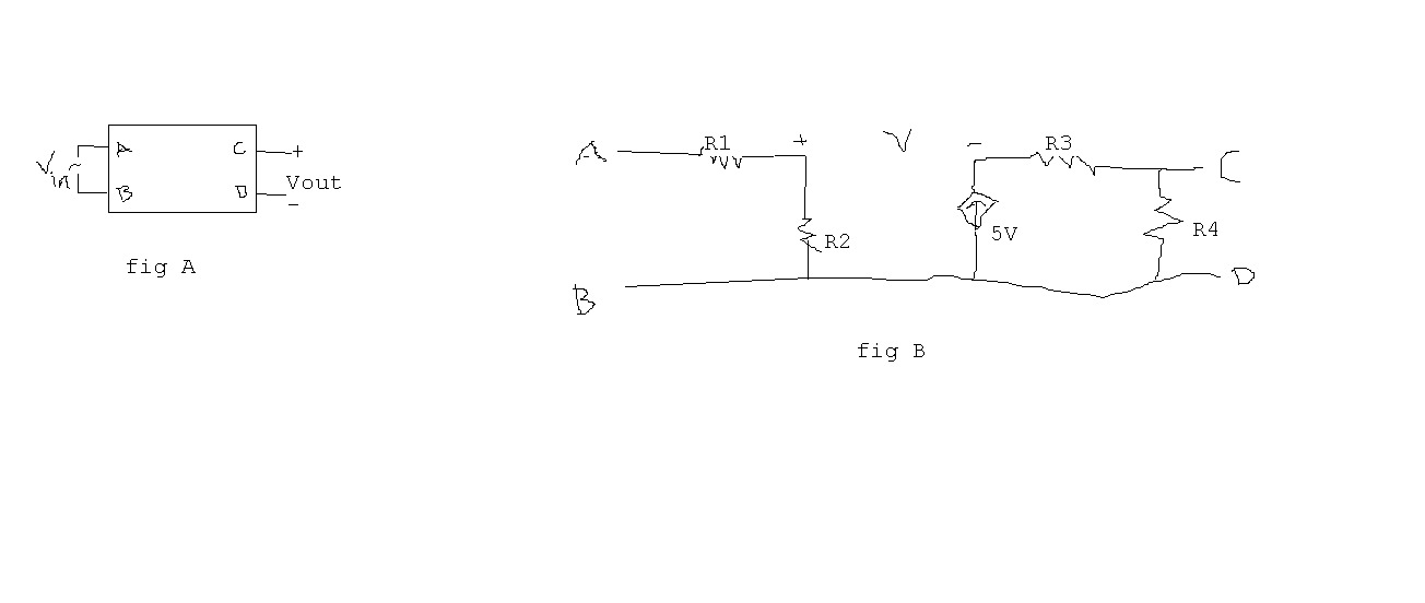

    What is your question? Where are you having trouble exactly?

    hi, my question is substitute fig B in fig A and find Vout/Vin

    here by applying nodal or mesh analysis
    I observed that no current flows to the second loop..
    then how the second loop will be activated....
    note:here 5V is the dependent source
    thanking you

    Its a simple network. Let the BD line be the reference node.
    First mark the two ends(+ve and -ve ends) of the voltage V as V1 and V2.
    Find V1 in terms of Vin by applying voltage-divider rule.
    Then find V2 in terms of V.
    V=V1-V2 and find V in terms of Vin
    Then find Vout.
    If you still don't understand then I'll post the pic of solution.
    There are other ways to solve the prob using 2 port analysis. But to start with my above solution will do.

    how to find v2 interms of v

    Simple voltage=current*resistance. current=5V resistance=r3+r4
    V2=5V(R3+R4)

    sorry 5v is voltage not current

    The output of the first potential divider is equal to the sum of the controlling potential V, and the dependant source voltage "5V".
    The input to the second divider is the controlled voltage source "5V". How is that expressed as a fraction of the output of the first divider?

    Well the diagram says its current source. Either the question is incorrect or the 5V is the voltage dependent current source.
    If its the latter then the problem has a solution(which I have already suggested).

    Right enough. The symbol on the diagram is for a current source ( the label "5V" means "5 times V", and does not tell you that its output is a voltage ).
    If the diagram is right my earlier post was nonsense. The problem is soluble in both cases, but you need to know which.
    @ veerendra: Can you confirm what the problem was really about?
