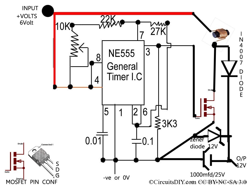

I recently got about 15 solar lights without batteries (and may be getting more soon), the solar panels put out around 3-4 volts each but I'd like to use them to trickle charge a SLA battery. I'd prefer parallel wiring to allow the use of different size solar panels, and I picked up a small inductor from radioshack a while back and never used it, so what's the best way with a single 30v 150a logic mosfet, a handful of small NPN and PNP transistors, a couple 555's and nearly unlimited resistors and capacitors and a couple 2 amp 50v diodes to build a booster capable of handling say 2 amps input at 2-4 volts and supplying minimum 14 volts output at full power? For cooling (if needed), I've always wanted to submerge a working circuit in vegetable oil (this does work, right?)
I've seen many circuits on google but I'm not sure which one fits my needs.
