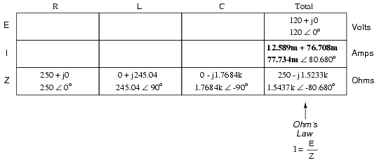

    Hi,
    Im new to the forum so HI everybody!
    Im reading through http://www.allaboutcircuits.com/vol_2/chpt_5/2.html
    and am at the section where you are putting the reactances into the table:
    [​IMG]
    The guide says "apply ohms law" but i cant see how you get the resulting values for currents.
    I prefer the 'j' notation as opposed to angular notation.
    There must be something im not seeing that combines the real and invisible part (j part) so you can get the two numbers!?
    Any guidance would be good.
    Thanks,
    Stuart

    When I use a calculator that can do complex arithmetic, I get exactly the results given in the example.
    If you aren't using a calculator or program that do complex arithmetic, then you must be doing the complex arithmetic yourself.
    Show the details of the computation and somebody can show you where you went wrong.

    I'm making up an excel sheet do to things for me starting from basic input values. Have got it so far as the current.
    The guide says "use ohm's law"
    So, i have 250 - j1523.3 Ohms at 120v
    I = E/Z
    I = 120/250 = 0.48A
    I = 120/1523.3 = 78.8mA
    Using a non-complex arithmetic calculator, how would you do the calculation you done using the complex one?
    Thanks,
    Stuart
    ps. im sure my calc can do it as it succeeded at doing this in uni in my electrical degree but i cant remember how!

    say you have x/(y+z) you cannot divide x by y and x by z and add them.Thats what you have done.Take the conjugate of the denominator that is multiply and divide the numerator and denominator by 250 + j1523.3 .
    The denominator is of the form (a+b) x (a-b).Now try it from here.

    I'm pretty sure Excel can do complex arithmetic. Look that up in Excel's online help. Using complex arithmetic is by far the easiest way to do it.
