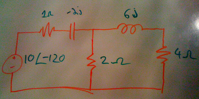

    hey guys:)
    wondering if my analysis procedure is correct for the cct.

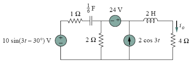

    I need to fined io for the following cct using superposition.
    [​IMG]
    so I gather I'm soposed to analyse the current io with resect to each individual source in the circuit, by zeroing remaining sources.
    I'm a little unsure of the "zeroing" of each source and if it causes a s/c or o/c.
    These are my circuits I determined by zeroing the sources. do they look right?

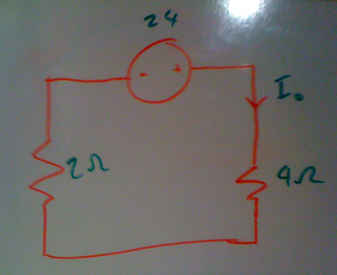

    This circuit contains a dc source. therefor the inductor =s/c cap = o/c

    Everything looks fine except for the first case where you are zeroing all other sources aside from the 24V DC source.
    You still need the 1 ohm branch with the capacitor, as well as the 2 Henry inductor and 4 ohm resistor.
    Are you assuming steady state for the capacitor/inductor? Is that why you aren't indicating that branch?
    I'm not entirely sure if you can do that. (Is there a reason you think you can?)
    Most of what I've learnt about circuits has been from other members on this fourm, and I myself am still learning.

    In my lecture notes it assumes steady state when analysing the DC source for a similar problem. The similar question to fine the voltage across a resister, results in three separate voltages which can be added together due three different frequencies (dc w =0), but is expressed at V = V1 + V2 + V3 (eg: V(t) = 1 + 26sin(3t +15) + 7.8cos(5t + 30))
    hope that helps... and thang you again for the help :)

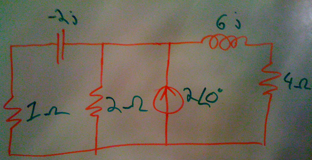

    Just checking if my method of finding Io for each of the circuits I drew is ok.
    first one is easy(24/6)
    for the second I have
    It = ((1-j2) + (2//(4+j6)))/10<-120
    io = It(2/(2+6)+j6)
    third cct
    Zt = [(2//(1-j2))]//(4+j6)
    Io = [(2//(1-j2)) / Zt] x (6<0)
    look ok?
