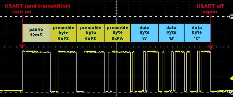

    Hi, I have these ask 434 mhz RF modules with atmega16 @11.0592MHz (for error free uart)
    When I transmit a data packet I need very large amount of preamble bytes (at least 10 to 15 ) all 0x55 or 0x54 ! otherwise the receiver can't adjust its gain enough to see the transmission
    Packet structure is [PREAMBLE BYTES,HEADER BYTE,DATA BYTE ,CHECKSUM]
    I want to avoid the large preamble size as it increases overhead and decreases bandwidth!
    If I transmit some data continuously to maintain sync between the transmitter and receiver then it works fine but this method consumes lot of power as transmitter needs to be running all the time
    What should I do?

    The gain will adjust quicker if you start the preamble with solid carrier, even just for 10mS or 20mS is usually enough to get the next bytes synced.
    There's some info on this page, that comes from simple tests;
    http://www.romanblack.com/RF/cheapRFmodules.htm
    It should not need 10-15 preamble bytes. Try a burst of solid carrier first, or transmit the first byte or two as 0xFF (I used 0xF8) instead of 0x55.
    Also add a couple of extra stop bits between bytes, this extra carrier transmission helps adjust the gain quicker AND gives better/easier sync of the following bytes;

    MAN AREN'T YOU AWESOME!
    I finally solved it using the details you gave me!
    the solution was to lower the BAUD rate to 2400bps and use two stop bits instead of one.
    Collectively what it did was increase the time for the receiver to adjust its signal gain level.
    Thanks a tonn for that link!
