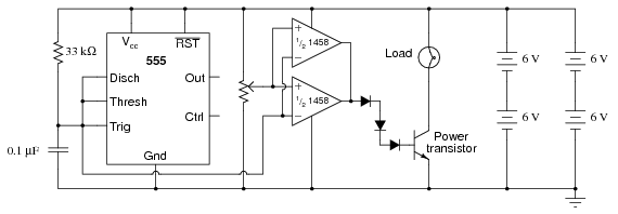

    RB: I am building this circuit and you mentioned a cap on the input of the comparator to make the switching freq around 4k. what size cap would you recommend? sorry, I can assemble and fix circuit, but I don't know enough to design them.

    True but... that size cap probably doesn't exist. That's why I included the resistor size. the formula is: Time = 1.1RC
    Time is 1/frequency

    The 1458 is an old and slow opamp that can't source much current, and you are trying to use it to drive a power transistor. That's just not going to work very well.

    I recognize this circuit from the AAC experiments volume. It would work, but a resistor in line with the diodes should be there. These experiments are verified (as in they have been built), but many of them aren't exactly practical. I'm not excepting my entries in this.

    bill, the circuit is the one you recommended from the experiments section.
    I am trying to drive a power transister that can carry a 10A load at a frequency that will not damage my peltiers I am trying to control.
    if the 1458is old, slow and cannot handle current, could you recommend one that could?..

    If you are using a 12VDC power supply you could use MOSFETs. I'm working on a new section for my article, you can read about how to use them in Chapter 10 in my work in progress area, LEDs, 555s, Flashers, and Light Chasers (forum edition). You will need to loose the op amps though. A 555 will drive a MOSFET well, put a 100Ω resistor between the output of the 555 and the gate.
    MOSFETs require almost no current on the gate past a single surge when switching. A BJT requires some current on the BE to keep them turned on. For large current applications this can be a major deficit.
