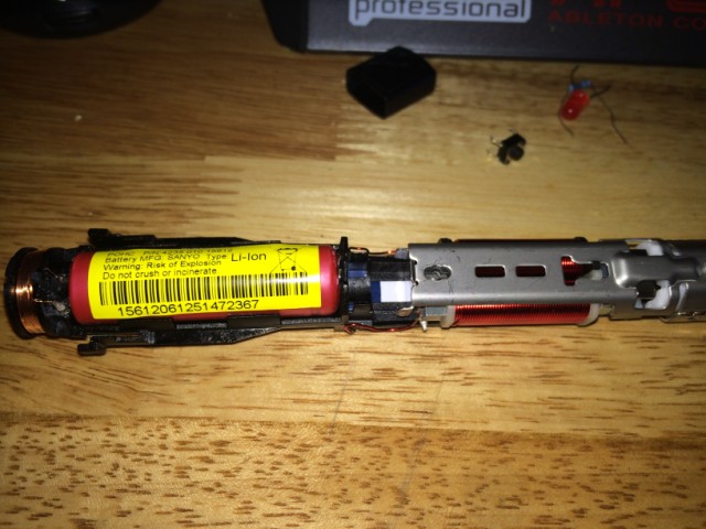

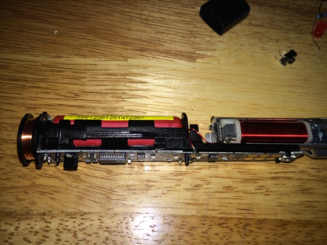

    I've pried apart my philips sonicare hx6750 toothbrushed and revealed its oh so glorious battery. It's a Li-ion (3.7V) battery, and I want to to remove it to connect it to a 3.3 V power supply and provide it with a bit of charge so I can get it working again.
    However, I can't get the battery out! Here are some pictures below. I tried to pry it from the end with an exacto knife and the top of the knife broke and got lodged in between :(
    I googled and couldn't find anything for my particular model, so I'm out of ideas and would appreciate any help!

    X-Acto knives.......are not for prying.
    It should pop right out of there, I think.:confused:
    Is it soldered?

    No it isn't soldered, it's in their real tight though and I can not pry it out.

    Is it glued in with that clear glue like used on some of the small batteries on mother boards?

    I would imagine that it is spot welded in place.

    Are you intending to keep the toothbrush? If not, judicious use of a hacksaw might do the job :D.

    Again, for maximum reliability, the battery would not be using simple pressure contacts. The contacts would have been spot welded to the battery and then soldered to the circuit board.

    I agree with Mr Chips. I had to replace a battery mounted that way in a Braun toothbrush. Your second photo seems to show two soldered pins protruding from the board in line with the two ends of the battery.

    The toothbrush I disassembled several years ago had the battery epoxied in place with some sort of hard, black epoxy.
