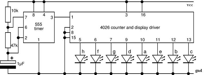

Here is one possible circuit, built in 15 minutes.
It works by utilising small temperature drifts in components. In simulation, the results will be predictable, but in practice, it will appear random enough.
Press the button more frequently to get the "die" to roll for longer (this could be a useful function.) Also, a "stop" button can be added, to stop the die from spinning. You may want to omit this. The capacitor across the switch ensures the die starts in a random position when it is switched on.
The circuit on the ctl pin is optional but increases randomness as it modulates the frequency of the clock signal and makes it more unpredictable. The diode in the discharge path is also optional, but it too adds thermal noise and variation to the delay.
Click here.

That looks like quite a neat random number generator.
For one way to implement a PRNG in pure logic, try a LFSR, which can be done with two or three 74xx series ICs.
