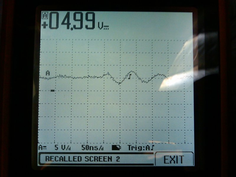

I went and made a quick choke (just took an unused loop of wire from radioshack), and added it in series to my 12V for the voltage regulator and here are the results from the scope for the 5V power source of my MCU:
without choke on 12V:
with choke on 12V:
that alone was enough to make my MCU run just fine, but I still don't like how the 5V line is shaky, I'd like to eliminate that completely.

Your scope plots are on a 50 ns time period which indicates > 1 MHz noise. You should definitly be able to filter out this noise in any critical areas of your circuit. Use parallel filter capacitors on the power (10 uF tantalum, 1 uf ceramic between power and gnd pins) right next to each and all ICs, including the micro. If there is still too much noise, use a small coil in series with the power line. Make sure the LC combination provides a cutoff frequency well below the noise frequency. Take your measurements right at the IC power pins. If possible, do a differential measurement between power and ground using two scope channels and the A minus B setting. (or a differential probe if you have one)
Also, note that there are more modern voltage regulators that have feedback bandwidth beyond the old 7805s. However, I doubt very much that you need to worry about that. High frequencies are elimated very easily with small coils and capacitors.
Another consideration is to make sure that your digital circuit ground is not in the direct path of the high current flow for the motor. This will generate a voltage gradiant across your ground and reduce noise margins.
If your micro or circuit has A/D converters, you may need to take more precautions to reduce noise.

ok i went through a lot of different revisions on my board because I found a bunch of other problems, but I am back to here again.
maybe I should have started a new thread, but it probably would have been frowned upon so i didnt.
the problem is, my PIC18 is being reset over and over because of the noise generated from my motor.
i went and took some new shots of what I was seeing on the scope.
I am seeing this on a large time scale.
and when I zoom in, I see this.
My new circuit now has a power and a ground choke, but I haven't done anything with any additional capacitors other than ones recommended for an LM7805 and PIC18.
Would it be sufficient to filter this out with some sort of LC circuit or filter?
