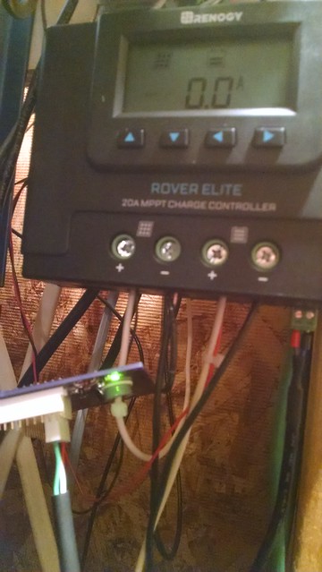

Rover Elite 20 amp MPPT

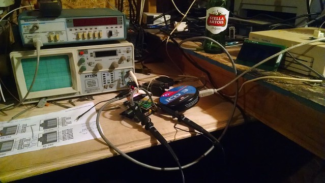

Spent a little time decoding the RS485 hardware on this unit. There is no documentation about it on the vendors side and nothing on the net yet on the hardware.
RJ45 test cable color code. Found after signal tracing for a bit.
Correct A/B pins
Unit signals (half-duplex) on the left. Rx and Tx pairs are connected together inside the DB-25 connector. I should (and will) use RTS to
shutdown the master RS485 Tx converter after sending data (and the master receiver to eliminate local echo) but currently it works without it on the very short test cable. ;)
RS-232 converter to Linux PC with 9vdc battery power for the converter.
RS485 breakout cable for Oscope monitor.
Finally Rover Elite command and response signals on the scope after a little signal tracing. Pretty slow, 9600 8N1 half-duplex will take while to download all of the data from the unit.
24V 20A modbus data from the CC.
Linux Qmodbus testing program slightly modified for this units command structure.
Model data. 52 43 43 32 30 52 56 52 45 2d 47 31 RCC20RVRE-G1
Software, hardware versions. :eek: V01.00.00 and V01.00.00.

I really only need one thing from the charge controller for my battery monitor. The charging state (bulk, absorption, float, etc...) is needed to keep track of battery cycles details. It's much easier to just have the mode instead of having a state machine function on the monitor computer trying to deduce the current charging mode from voltages and currents. My plan is to have a dedicated 8-bit microcontroller (PIC18F1320) on the modbus (using the 5vdc on the RJ485 plug) that decodes the register data and sends an analog voltage (using PWM for a DAC on a digital channel) to one of the battery monitors ADC channels as a series of voltage steps [0,1,3,4,5] for each mode.
Linux libmodbus program (modified from the original temperature sensor measurement example program for my configuration) to read the current charging state/mode.
https://libmodbus.org/docs/v3.1.6/
Changes from 2 to 0 as the AC charge is turned off.
https://techsparx.com/energy-system/modbus/linux-modbus-usb-rs485.html

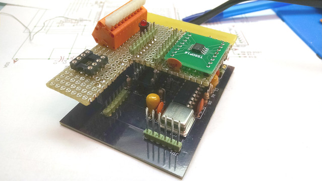

Have my prototype MODBUS controller build from a former project board with signal headers and a daughter board.
RS485 transceiver.
I have a proper PCB ordered but it won't be here for a while (China). This allows for software development (in C18) during that time.
PWM (green) and RS485 (red&blue) throughput testing on the PIC18F1320 @40MHz PLL clock.
