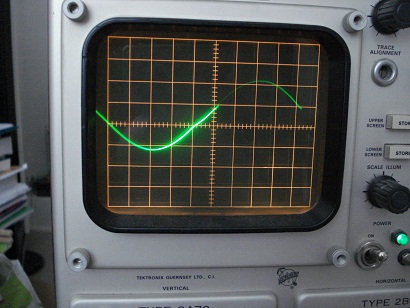

Been trying this afternoon to get a triangle/sine wave from my PIC by using the PWM-module as a D/A-converter.
Here is the setup:
A PIC16F887 running @ 8 MHz (internal clock)
PWM-module activated (prescaler set at 4, PR2 = 127) and a RC-circuit on the output.
Because it is running at 8 MHz with prescaler at 4 the period-time of the PWM would be:
T = (127 + 1) * 4 * (1/8000000) * 4 = 256 µs
The RC-circuit is chosen as following:
R = 10 kohm
C = 1 µF (electrolyte)
This means that the time-constant is 10ms, which should be enough?
All I get on the output is this:
http://www.youtube.com/watch?v=69ZuGRKI658
And with a other RC-circuit:
http://www.youtube.com/watch?v=EbwOcoxVFPk
What am I doing wrong?
