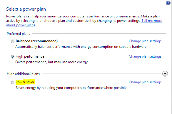

    Being plugged into AC vs Battery should not change the operating speed of your computer. If you are using Windows, check the bottom right corner of your screen for your power settings, and see if your "On Battery" profile has speed set low, like CPU speed, hard drive speed, etc... If you are in "Power Saving" mode, your computer will surely run slower than if when it is plugged and using "Extreme Computing Hyper Awesome" mode. See image below.
    [​IMG]
