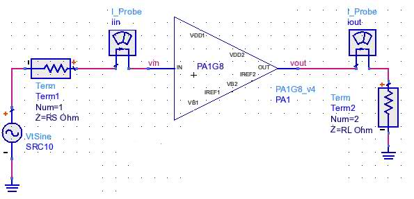

    I'd like to measure the Power Gain of the following PA.
    Am I doing it correctly in the following way?
    Please notice that I measure vin AFTER RS (not Before RS).
    Pin_avg = avg (iin * vin)
    Pout_avg = avg (iout * vout)
    Gain = 10*log(Pout_avg / Pin_avg)
    Should I measure vin before RS? (i.e. measure the voltage source's voltage).
    Thanks!

    Yes, it looks like you are doing it correctly.
    No, you do not want to measure V_in prior to R_S because the power gain is the ratio of the power delivered by the amplifier to the power consumed by it. The power being dumped in R_S by the source is being consumed by the source, not the amplifier. Besides, it is possibly a modelled output resistance and does not reflect any true power consumed at all - the true power consumed by the amplifier could be a lot different, either higher or lower. The point being, that your amplifier doesn't care about those details, because it only sees the voltage applied to its input.
