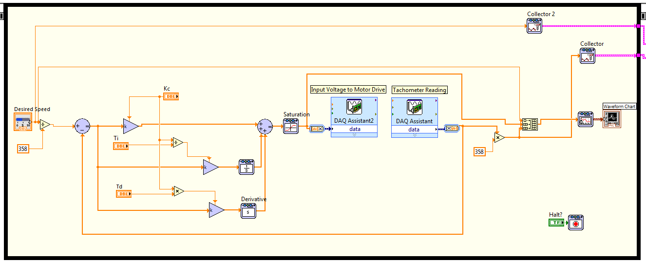

  8. YukiWong
    Thread Starter New Member
    Dec 5, 2011
    27
    1
    I just do it in simple way through Labview 2011 control and design simulation toolbox, picture below show the regarding Labview Vi block diagram.
    I had used convert to dynamic data and convert from dynamic data to convert the controller output into dynamic data before and after DAQ Assistant.
    [​IMG]
    Is the picture helps to understand how my real-time validation been done?
    Thanks for your reply,thankyou very much :)
  9. t_n_k
    AAC Fanatic!
    Mar 6, 2009
    5,448
    790
    While I understand what you are doing I'm a little puzzled ....
    You are simulating a DC drive which presumably has the same plant transfer function you gave earlier. Is the DAQ assistant providing the interface for driving a physical DC motor with shaft tachometer feedback? Are you sure the transfer function corresponds to actual system?
    Also you seem to be validating a PID control method whereas your original investigation was based on a simpler PI control system.
  10. YukiWong
    Dec 5, 2011
    27
    1
    Yea, thats is what i gave earlier.
    Yes, it is a DC motor with tachometer feedback.
    Yes, they are interface through the I/O port of the Labview NI card.
    The transfer function is not really correspond to the actual system, because the gain for different value of voltage input are difference. I am just taking the average gain,time constant and time delay while doing model development to improve the accuracy. It is not 100% correspond to the real plant.
    It is a parallel PID controller, initially the Td is equal to zero will equal to the PI controller.
    thanks for your reply,thank you :)
  11. t_n_k
    AAC Fanatic!
    Mar 6, 2009
    5,448
    790
    Well if the physical system transfer function bears no relationship to the original model, you can hardly expect the physical system response to bear any resemblance to the one you have calculated in your modelling.
    You need to think through your concepts more carefully - preferably before posting your questions on the forum.
