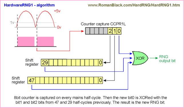

Sorry it got late at night posting those and I didn't get around to the "asking for help" bit.
Since the output random data from the LSB is good quality but has a small bias, I wanted to use the other 2 bits that are available in each sample and use some hashing process to merge that data into the LSB output in a way that would remove the bias.
Ideally this would also introduce some more entropy to the output, so would not only fix the bias but might also increase the quality of the RNG output.
Since I have 3 seemingly "good" bits from each sample, my first thought was for every sample to put the bit1 and bit2 into their own shift registers, and after some amount of cycles hash the output bit from those shift registers with the new sample bit0. This would hash together 3 bits, taken from different points in time.
Hopefully this would fix the small 0:1 bias in the LSB. If there is still some bias, then I could also hash in a repeating 0101 sequence which would give a result of inverting every second bit, a rather strong way of removing the bias.
I'm interested in any feedback from people on the best way of doing this. From what I understand about XOR hashing it never loses any entropy from the data, but it may dilute it. For instance if I XOR the 4 separate bits; bit0, bit1, bit2, and the 01 pattern, then the LSB is only responsible for 1/4 of the entropy in the final data.
Although no entropy from the LSB is lost, I would prefer it if it is responsible for the majority of the output, and the other 2 or 3 bits only partially responsible. I prefer that because technically the LSB has the highest entropy of all the bits.
THE_RB
Joined Feb 11, 2008
5,438
I've done some tests hashing the other 2 bits with the bit0, results are looking good.
The procedure is very simple, the bit1 and bit2 are shfited into two separate shift registers. Then for every new sample, the new bit0 (from this cycle) is XORed with the bit1 from 47 cycles ago and the bit2 from 29 cycles ago. Since there should be no statistical correlation between a random bit0 from this cycle and a random bitX from Y cycles ago, this adds additional randomness to the output and also the XOR process should be enough to remove the small bit bias that seemed to be in bit0.
I've collected a couple of sets of data and will soon post the results. :)

Just an update, the new software has been tested using this simple (non-math) XOR algorithm;
and the results all tested quite nicely;
So I have written the project up and put it to bed. :) The C source code and everything you might need to make one, or play with this concept are on my page here;
