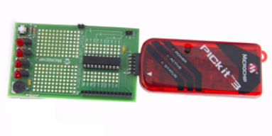

    This is almost the "buy or build" question we all face: should I spend the time to design, build, debug, and refine some new thing I need, or just go out and buy the nearest equivalent?
    Both John P and DerStrom8 make some good points here. When starting off the beginner can use all the hand holding possible. That first embedded project combines building a circuit, writing and compiling some code, connecting a programmer, and observing the results.
    And if those results are as exciting as watching a paint dry what does one do? At least paint does *something* (gets less sticky), what if your project just sits there, no LEDs blinking, no "zip" when it moves, no "bop" when it stops, no "whirr" when it stands still?
    So when at the starting gate I lean towards DerStrom8's view. With so many variables in an embedded project (circuit design, circuit build, component integrity, code correctness, programmer correctness) to contend with a beginner can use all the assistance possible!
    That is why a purchased, assembled, and tested development board with a programmer are on the top of my suggested list. They sit there on my list along with a set of lesson plans for the board. Such a board, as minimum, needs an inexpensive push button, some LEDs, and a potentiometer. That will teach you the basic operations of inputting digital (the button) or analog (the pot) signals, and making some digital output observed on the LEDs.
    Now you have some very useful tools that together eliminate the variables of the design, the build, and the programmer, and you can concentrate on the code until it works.
    It may be useful to also provide some general connections for "expansion," some way to use the board once the lessons are complete. I've used these boards as a starting point for a few projects when I just need a micro and little else. Heck, for a few years I even used my PICkit ONE as an ICSP programmer by adding some jumpers to daughter boards.
    When I do need anything beyond that beginners board John P's comments make more sense. While I don't use solderless breadboards I have until the last couple of years used the Radio Shack soldered breadboards that mimic the same pin pattern. PICs are obtained in DIP packages and centered directly on the lands. ICSP goes into a corner taking up very little room. Come out neat and proper, but it's no where near my first trip around the block.
    With breadboards I never had the need to convert a DIP package to another DIP package.
    Lately I've changed to using mostly SMD parts for bread boarding. While 0805 resistors can fit on those RS boards you can pull the lands way too easily, so I now use inexpensive bread boards I get from China. These are just a sea of plated thru holes on 0.1" centers. They also look much nicer!
    I do use adapter boards all the time to change SOIC and QFN to 0.1" patterns. My development boards tend to look like this (partially disassembled) prototype:
    [​IMG]
    My choice for starter board:
    PICkit 3 Low Pin Count Demo Board
    [​IMG]
    DerStrom8 and tracecom like this.
