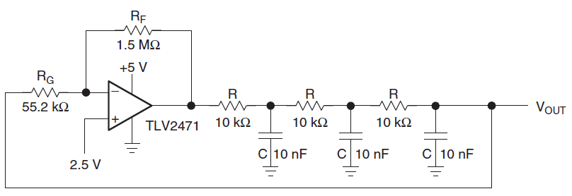

In the following Phase Shift Oscillator ¿What is the purpose of the 2.5[V] at the non-inverting terminal?
I already developed the equations for almost the same circuit except that the non-inverting terminal is tied to ground.
I've found that the gain A = 29 so that the circuit oscillates at a frequency of f= 1 / sqrt(6)*R*C
The simulations are not consistent, as for the current circuit the sine wave seems at the output to be shifted 2.5[V] but when I put 1[V] for example the signal fades over time.
Do the 2.5[V] affect the gain or frequency? If so how?
OR
Are those 2.5[V] just for to shift the signal? Thank you.
