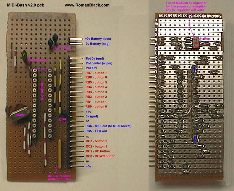

I have this prototyping board that Im supposed to use for a soldering project. I have to solder in some ICs and such, but I noticed all the solder pads on each row are electrically connected. When using this type of prototyping board, would you cut the traces down the center to put in the IC and solder it up?
If anyone has some example pictures of this prototype board it would be helpful. I would much prefer to use a different prototype board, but this is the one Im stuck with.
