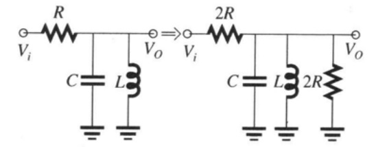

Task:
Modify this bandpass circuit to change its center-frequency gain from 1 to 0.5 without changing \(\omega_0\) or \(Q\).
The general transfer-function of a bandpass is
\(T(s) = \frac{a_1 s}{s^2 + s \frac{\omega_0}{Q} (\omega_0)^2}\) where the natural modes can be found by finding the poles of any response-function without altering its natural structure.
As the natural modes of the left-hand side are \(s^2 + s\frac{1}{RC} + \frac{1}{LC}\) and the natural structure isn't changed on the right-hand side of the alteration, the natural modes should stay the same as follows: \(s^2 +s\frac{1}{(2R||2R)C}+\frac{1}{LC}.
But by calculation
\(T(s) = \frac{\frac{1}{\frac{1}{R} + \frac{1}{sL} + sC}}{2R + \frac{1}{\frac{1}{R} + \frac{1}{sL} + sC}} = \frac{1}{1 + 2R({\frac{1}{R} + \frac{1}{sL} + sC})} = \frac{1}{1 + 2 + \frac{2R}{sC} + sC2R} = \frac{sL}{sL3 + 2R + s^2C2RL} = \frac{\frac{L}{C2RL}}{s^2 + s \frac{3}{2}\frac{1}{CR} + \frac{2R}{C2RL}}
= \frac{s\frac{1}{2CR}}{s^2+s\frac{3}{2}\frac{1}{CR}+\frac{1}{CL}}\)
As one can see, the center-frequency gain indeed has been halfed - but despite theory about natural modes \(\frac{\omega_0}{Q}\) has been altered.
(Problem 16.37 from Microelectronic Circuits, 6th edition.)\)
But by calculation
