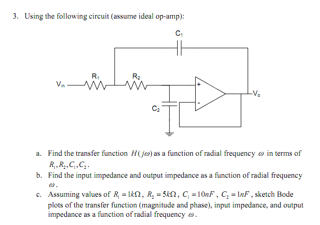

Here is the circuit
Here are the equations I have so far:
Are these correct? The first two are obtained from voltage divider and the third one is obtained using KCL at the node between R1 and R2, V1. If these are correct, I'm having a hard time figuring out how to solve for Vo/Vi in the algebra...
