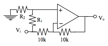

For the op-amp below, I am solving V_o in as a function of V_i.
Here are the equations (using KCL) I have so far.
V_i - V+ = I_1 * R_1
V + = I_1 * R_2
V_i - V- = I_2 * 10k
V_o - V- = I * 10k
I am not sure how to apply KCL at the node between the two 10k resistors. Thanks for your help.
