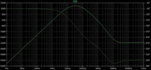

I have a two question.
1. Differentiator
I designed differentiator with op-amp which operate for change triangler wave input signal to rectangular wave.
So i designed below circuit.
and it's AC response is
in this situation, i want to know how can i estimate the rise/fall time from the AC response???

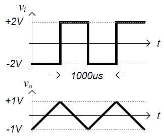

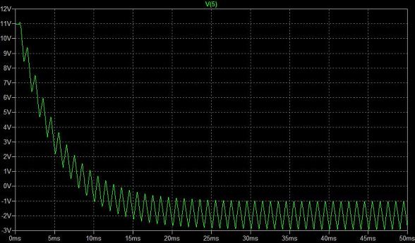

2. integrator
I designed integrator with op-amp which operate for change rectangular wave input signal to triangler wave .
i want to achieve this input and output signal.
circuit
but result was like this.
output signal is oscillate with -2V as a center.
how can i change this output signal to above output signal?
