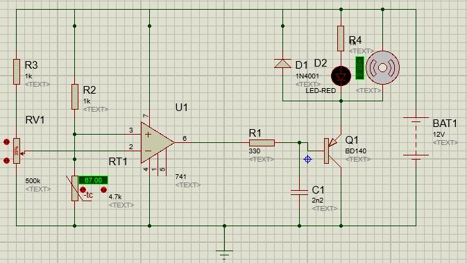

Hi. I want to make temperature controlled fan circuit and read the value of temperature using Arduino(serial monitor).
.I made this circuit but it doesn't work with arduino correctly. I have connected NTC to Arduino like this
. What can I do to fix this?

What is the Arduino reading? You have 5 VDC applied across your temperature sensor in series with a 10K Ohm resistor. What temp sensor are you using (data sheet) and what code are you using (post the code). Finally what is the Arduino reading for A0 the analog in you are using?

If the circuit is exactly as per your schematic, then with 12V at the top of R2 and a thermistor having a resistance of ~ 4.7k you will get nearly 10V across the thermistor! Your breadboard layout seems inconsistent with the schematic.

If you swap the positions of R5 and RT2, then the only connections needed to the arduino are the top of the thermistor to the A/D input, and GND.
Also, why do you think you need R5 in there at all?

I suggested you try the Arduino using the circuit shown with the 10K resistor and 10K Thermistor in a divider configuration with 5 Volts applied.
The Arduino Analog In will convert the analog voltage from the divider or any analog voltage of between 0 and 5 Volts to bits and in this case 0 to 5 Volts equal between 0 and 1023 bits.
You also need to read what Analog posted regarding Thermistors as they are extremely a non linear temperature sensing device. That said then you need to understand how analog input bits are converted to an engineering unit be it temperature, pressure, flow or any other engineering unit. You can't just take your existing circuit and add an Arduino to it.
I suggest you read and understand The Simple Code, The Elaborate Code and The Elaborate Code Cleaned Up a Bit. There is quite a bit to all of this and you can't arbitrarily feed a signal into an Arduino and expect results with an understanding of how all of this works.

Problem 1.
741 op amp.
Generally speaking 741 needs +/- 15 volts (30 volts total). You are providing 741 with dinky 12 volts.

TI datasheet says minimum of +/- 10 volts to power 741. That is total of 20 volts. So. I would say your 741 is not working and your circuit is not working.

The 741 datasheet says the minimum *recommended* operating voltage is +/-10 V. However, the part will operate just fine down to the point that the input common mode range and output voltage swing range no longer have any operating room. This is somewhere below +/-5 V. Into a medium impedance load such as 10K, a 741 runs just fine on a single 9 V battery as long as you don't need a large output voltage amplitude.
