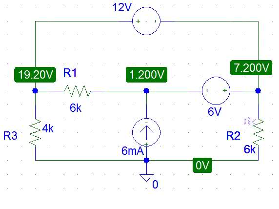

    I have to solve for V0 , using nodal analysis. I am getting different answers in matlab and PSPICE. The circuit is below
    [​IMG]
    2 supernodes ; or 1 big supernode Here are my nodal equations:
    v1-v3 = 12
    v3 - v2 = 6
    (v3)/6k + (v1)/4k - 6/k = 0
    Matlab output is here:

    PSPICE Schematic:
    [​IMG]
    So confused!!!!

  2. t_n_k
    AAC Fanatic!
    Mar 6, 2009
    5,448
    790
    A couple of your matrix terms look wrong - you should have values like 1/4000 = .00025 and 1/6000 = 0.000167 there somewhere.
  3. t_n_k
    AAC Fanatic!
    Mar 6, 2009
    5,448
    790
    BTW - the PSPICE worked correctly.

  6. t_n_k
    AAC Fanatic!
    Mar 6, 2009
    5,448
    790
    Starting equations were correct but Matlab stuff should be like this ....
    -->A
    A =
    1. 0. - 1.
    0. - 1. 1.
    0.00025 0. 0.0001667
    -->b
    b =
    12.
    6.
    0.006
    -->inv(A)*b
    ans =
    19.2
    1.2
    7.2
