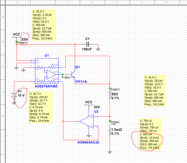

Hi folks, I'm designing a Milli-ohm measurement test board wrt to this schematic designed by K.Wong. http://forum.allaboutcircuits.com/c...ontent/uploads/2011/08/milliohmmeasurment.png
source: http://www.kerrywong.com/2011/08/14/accurate-milliohm-measurement/
and I've finished the left half , the current source part. I did a spice simulation as below:
I'm trying to get a fairly high (500 mA ) current, so my ckt ends up pumping 10V to the positive input
to the AD8276 diff. amp. And also the Vs for the diff amp chips is using 22V(or i think 24V is fine too).
I'm looking for some suggestions on how to implement the power supply circuit/components for the final test board.
I'm planning to use wall plugs(120V), so I'd need a converter(possibly an Open Frame converter?) to bring it down to maybe 20~30V, then another component that regulates it to 22V or 24V to feed the AD8276. Also I can see I'd need something(maybe a buck converter) to generate the 10V on the positive input on the amp.
I haven't designed any voltage regulator before and have little experience . Could anyone give me some suggestions on how to achieve the conversion from 120V wall outlets to a fairly stable 22V/10V voltage ? I'd appreciate it if you could name some specific parts or designs that do this.
Thank you.
