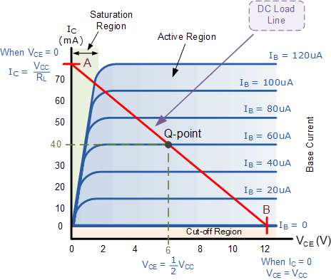

Hello.I am having a problem in understanding the Collector Characteristic Curves of a transistor.
In the figure above,why is Ib=0 till the cut-off Region?I have read my text book but I do not understand the relationship of Ib with this graph.Please help me out.Thank you
