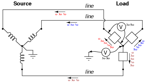

    I have a problem in understanding how the harmonic currents exist in a load with no corresponding harmonic voltages?
    The following figures with questions under explain what I mean
    [​IMG]
    This understood figure no issues about.

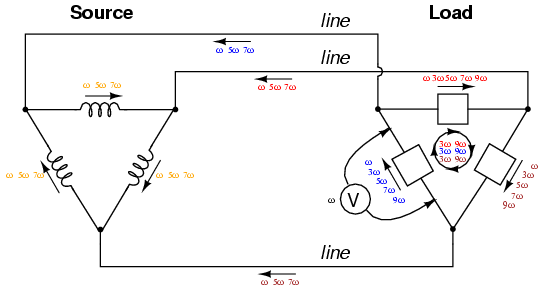

    [​IMG]
    In above figure, 2 question arise::confused:
    • How the line currents are missing the triplen harmonics
    • How the phase voltage is missing the other odd harmonics except the triplen

  2. t_n_k
    AAC Fanatic!
    Mar 6, 2009
    5,448
    790
    Attached is my attempt at an explanation which unfortunately is rather wordy.
    mnada likes this.

    I really appreciate your time and effort. Your response is quite helpful
    I fully agree with you that the second figure is missing the fundamental frequency voltage across the star connected load, that make perfect sense.
    Regards,
