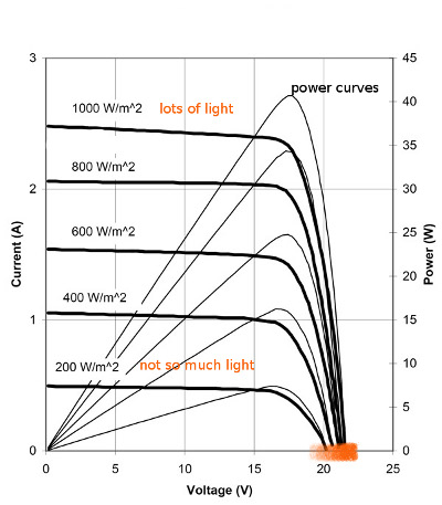

  19. THE_RB
    AAC Fanatic!
    Feb 11, 2008
    5,435
    1,306
    Just use a SMPS (buck etc) set to regulate INPUT voltage.
    The solar panels MPP is always at the same input voltage, generally about 17v for a 12v panel.
    You don't need any peturb/observe or other fancy system, just adjust the PWM to keep the input voltage at the correct amount. You can do it with any standard bcuk regulator IC and a transistor to invert the voltage Fb pin.
    Sensacell and ronv like this.
  20. ronv
    AAC Fanatic!
    Nov 12, 2008
    3,419
    1,734
    Never thought about that. :eek:
